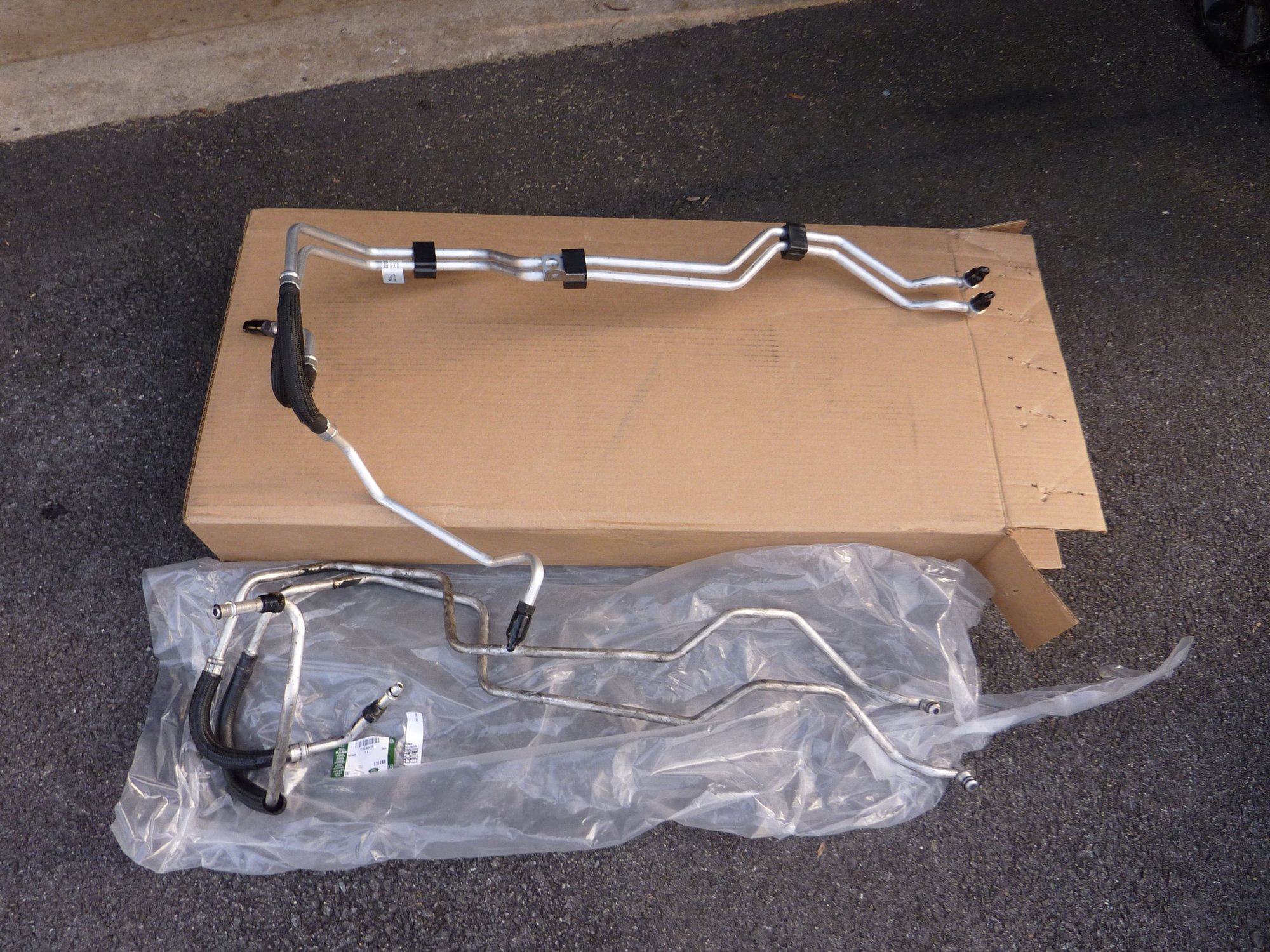

My new trans cooler lines came in just now. The plastic pieces that hold the lines together seemed to be way more brittle than my old ones. Broke two of them. Still have the old ones.
So will start the arduous task of "threading" the new ones into place.

I managed to get the new transmission cooler lines "snaked" into place late yesterday.
However that is after dropping the steering rack AND lifting the engine about an inch!
No way could I snake the lines without significant distortion. Way too much in my opinion.
So then I dropped the steering rack which was very easy to do only 3 bolts. Still no joy.
Then I took off the two nuts on the engine supports and jacked the engine up from underneath about an inch. It took a lot more jacking than just that because the whole car would raise up as the engine weight was taken off the struts.
Once I did all that I was able to snake the lines thru one at a time. Still needed a bit of force but not much. Also fed the lines in from the rear.
Took about 30 minutes total to drop the rack and raise the engine and some of that was finding the correct sockets.
So today will bolt everything back up and finish the fill procedure.
One thing I forgot to mention was the fact the catalytic converter was in the way so did loosen it to move it about an inch which helped.
