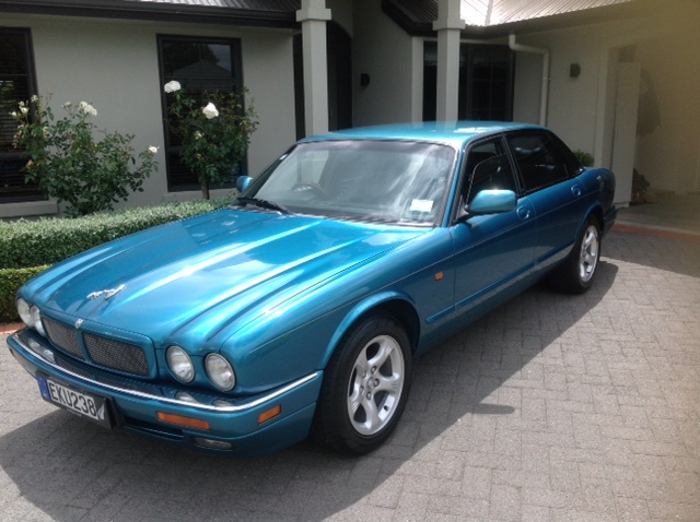

Hi everyone. I came across this forum while searching for a possible solution to my VERY annoying problem!
I have a 1994 Jaguar X300 XJ6 Sport which I have been restoring back to her former glory over the last year. Over the last 2 months I have had the wheels aligned 3 times by so called professionals yet after each time, the steering wheel does not stay centered for any more than three days. It tilts to the left when driving and is now so far over to the left that it blocks the temperature gauge. The car still tracks well, its just the steering wheel does not want to stay centered. I am very reluctant to take it back to Jaguar as I seem to be throwing money at a problem that dosnt go away, plus the tech guys there seem to be at a loss. The front end was dropped recently to put new shocks and suspension bushes in, wheel re aligned (again!) yet the problem still persists. Any advice on how to remedy this or possible causes would be greatly appreciated. Thank you. Mark, New Zealand.
