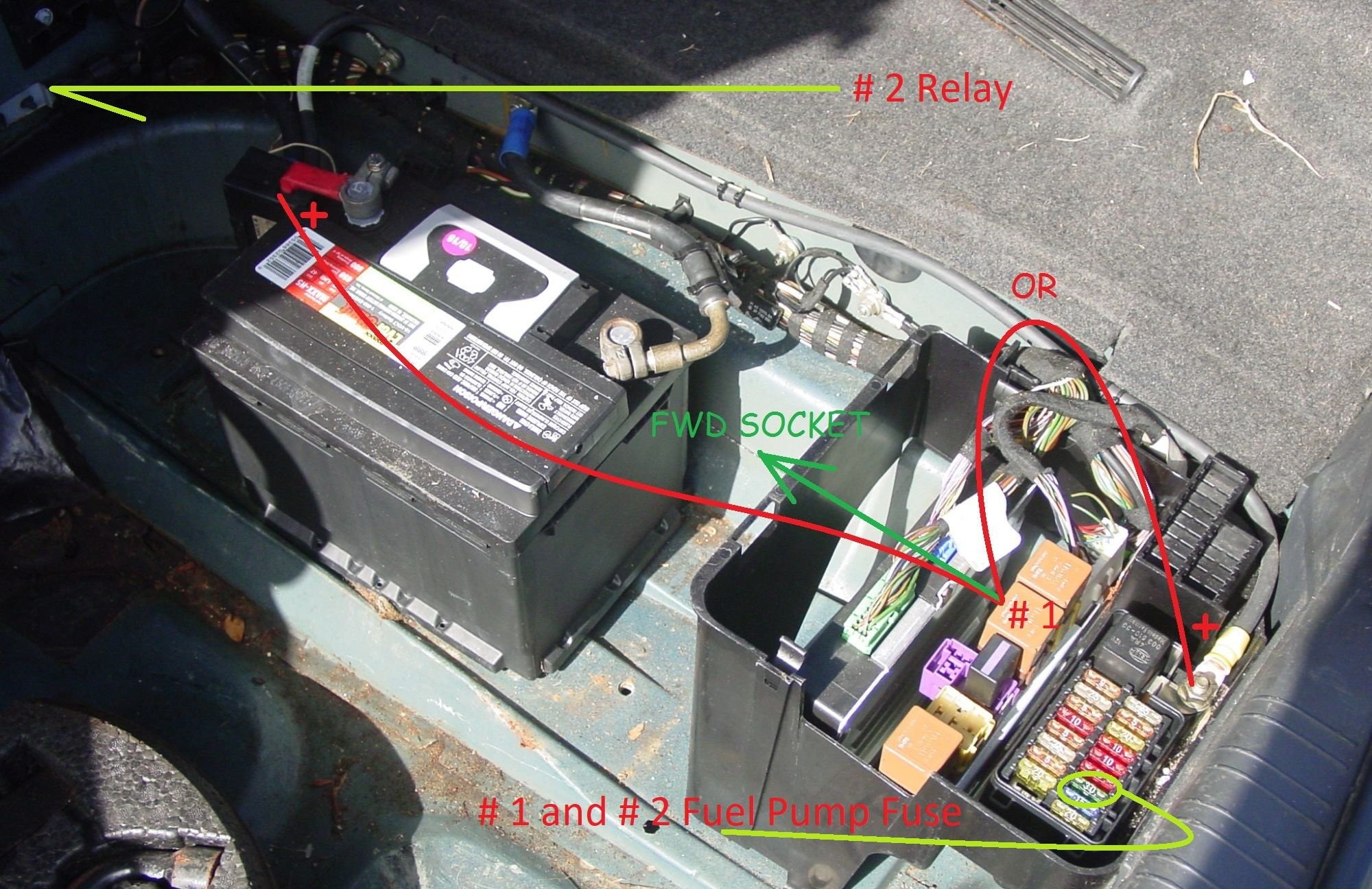

The CKPS was the correct choice but the new one is probably bad out of stock
Thinking / editing
the first 3 seconds of fuel pump operation is triggered by the ignition switch
The second turn back on for the duration of your drive is the CKPS seeing engine rotation / safety design
You can jumper the fuel pump relay to keep the fuel pump running at all times but this will drain the battery with the keys in your pocket
Pics coming
Your power sockets are 3 and 5 or 30 and 87
You'll have to use heavy gauge wire with blade type connectors for better connection , the auto parts store counter can sometimes make one up for you
The CKPS CEL code P0335 will not always appear in its different modes of usage like fuel pump enable
