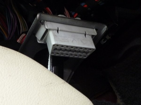

I've looked down by the bonnet release catch, as per some posts on here, but there's nothing there. There's a connector in the DS footwell near the radio, looks like the attached image - is that it?
