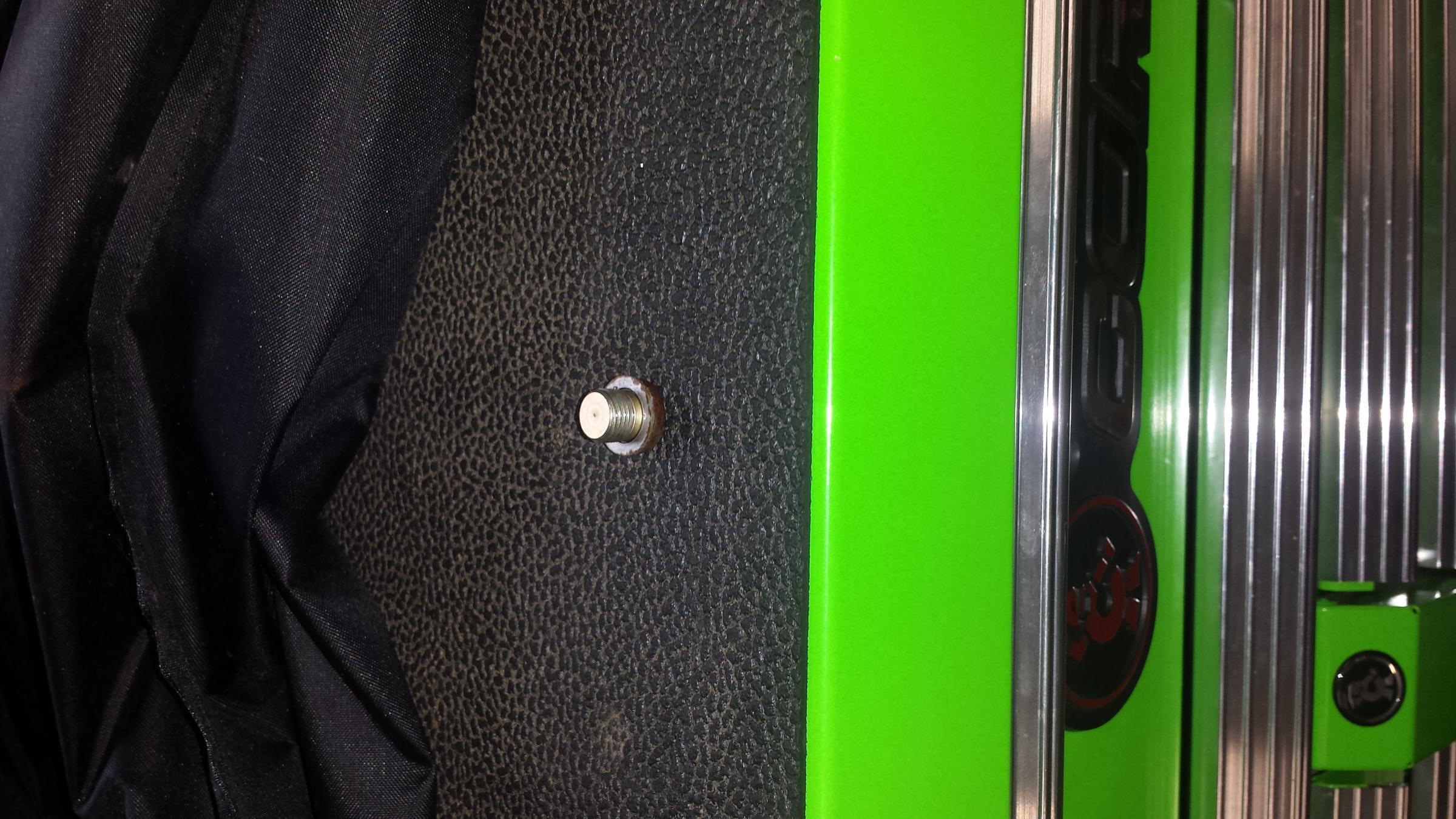

Sorry I've been M.I.A. lately, work has been keeping me busy. Here's a little update while draining the trans fluid. As you see I am one of the lucky ones who have the drain plug (for all you non believers they do exist!) I am going to refill and head to work I will let you guys know how it shifts. And for reference I went with the red line synthetic D4, as per a recommendation from a fellow enthusiast on here. Sorry I don't have the name to give credit where credit it due haha. I'll post after my drive to work if I get it done in time.
Drew
