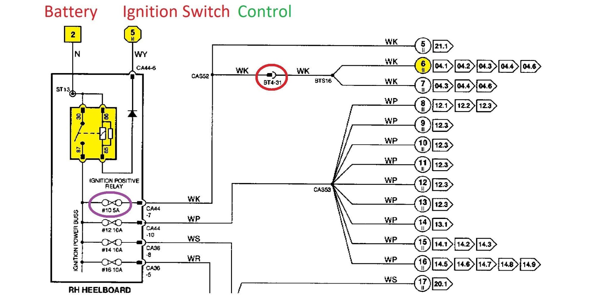

aside from fuel pressure there are 2 souses of power for the engine ECU
!st power is the right engine bay fuse box fuse # 12 ( this is point 32 double hash circle ) which requires the ignition positive relay to close in the corner of the fuse box
2nd power which is used at all times is the large ECU Control relay which is controlled by the ECU and brings power back into the ECU
you can swap the right engine fuse box relay ( ignition positive relay ) with the left ( only runs the car horn ) and the large ECU Control relay for a headlight , fog , or AC relay of the same part #
This relay also powers the fuel injectors

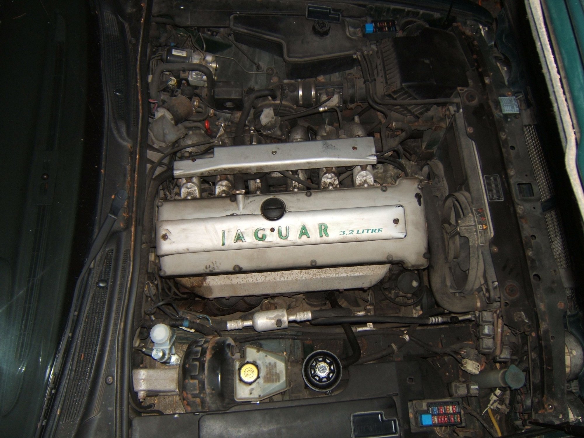

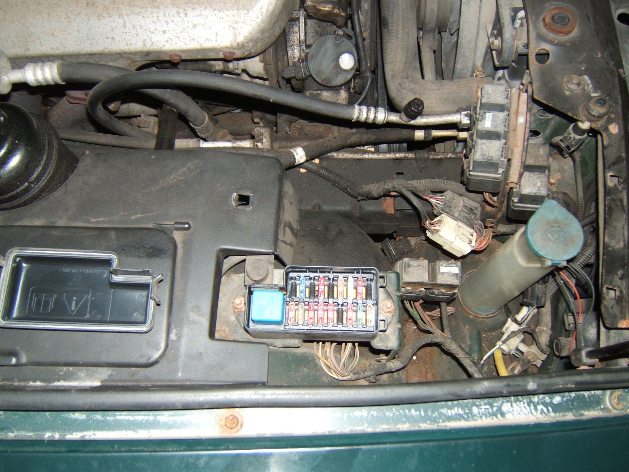

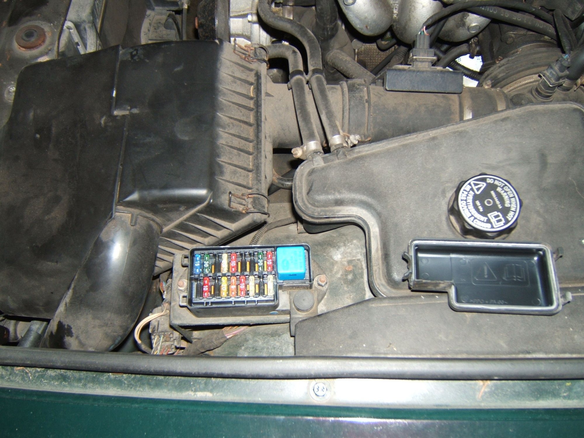

Not so much that I don't want to, I just haven't had a need to until now. I have started looking at more sophisticated scan tools. Would like somewhere in between cheap knock off from Chi-na vs. mega Dollar Snap-On!
Attached are a couple of engine area photos. No secondary AIR on this car either.
Relays are quite cheap so I might just buy some new spares rather than trying to swap them around.

You can do the same socket 3 to 5 jumper Ing with a heavy wire with blade type connector ends on the blue relay in your pic ( ignition positive relay ) in the right engine bay fuse box
The left engine bay fuse box relay one only controls the car horn
This takes the right relay controlling ignition switch out of the equation
You have the same situation with the left and right heelboard fuse box as the right is referred to as the 2nd ignition positive relay and the right provides power on the control half of the fuel pump relay through fuse # 10 after the right relay heelboard fuse box is closed
This even applies to the large ECU Controlled relay and I am double checking the socket #s , yes the same 3 to 5 after double checking
Leaving the jumpers in place with the keys in your pocket will eventually drain the battery
The fuel pump control half of the relay gets its power through the BT4 connector above the fuel tank which can be troublesome in reconnecting, but you can visually ensure the lock over bar is tie wrapped in the secure position
The wire is in position 31 as the White / Pink color
