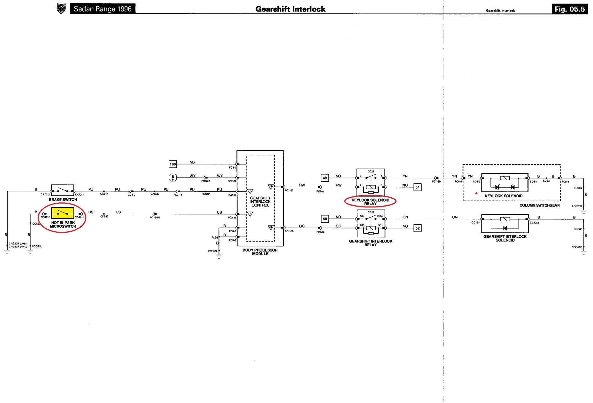

With key in a certain position, I can't recall by slightly moving the shift lever out of the park gate you will feel a click on the ignition key barrel from the key barrel lock solenoid not in park switch system , so this directly test the not in park switch
There is the importance of replacing the not in park switch with the proper normal open or normal closed
There is also a shift lever solenoid system
Relays involved
Pic coming
See page 20 of the upcoming Doc
X300 1996 LWB.pdf (jagrepair.com)
The transmission rotory switch is used as a enable or through path to allow the starter solenoid relay to close
It has an adjustment but I wouldn't adjust it just yet or lose what you have
It has some delicate wiper fingers inside that can be cleaned with a pencil eraser
