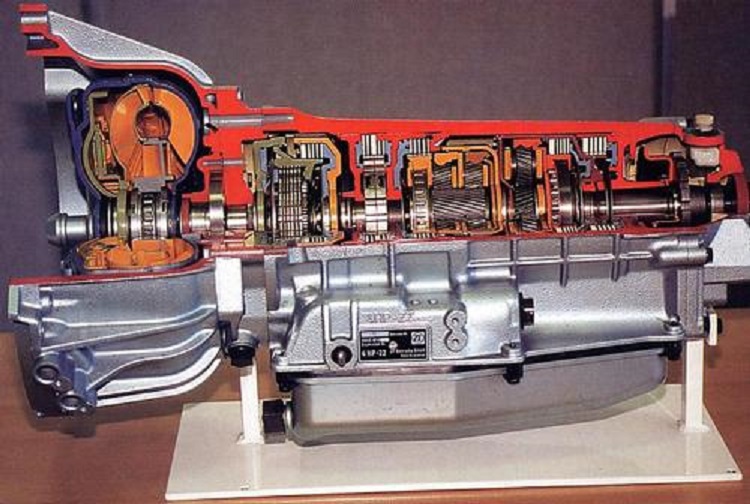

There is a round electrical connector on the left aft side that may have got some sort of contamination . You can pull it and flush with some contact cleaner without jacking the car . The separate transmission ECU lays flat on the bottom of the passenger seat opening {L or R ) and has a long connector easy to get to and clean . Bosch unit label .
