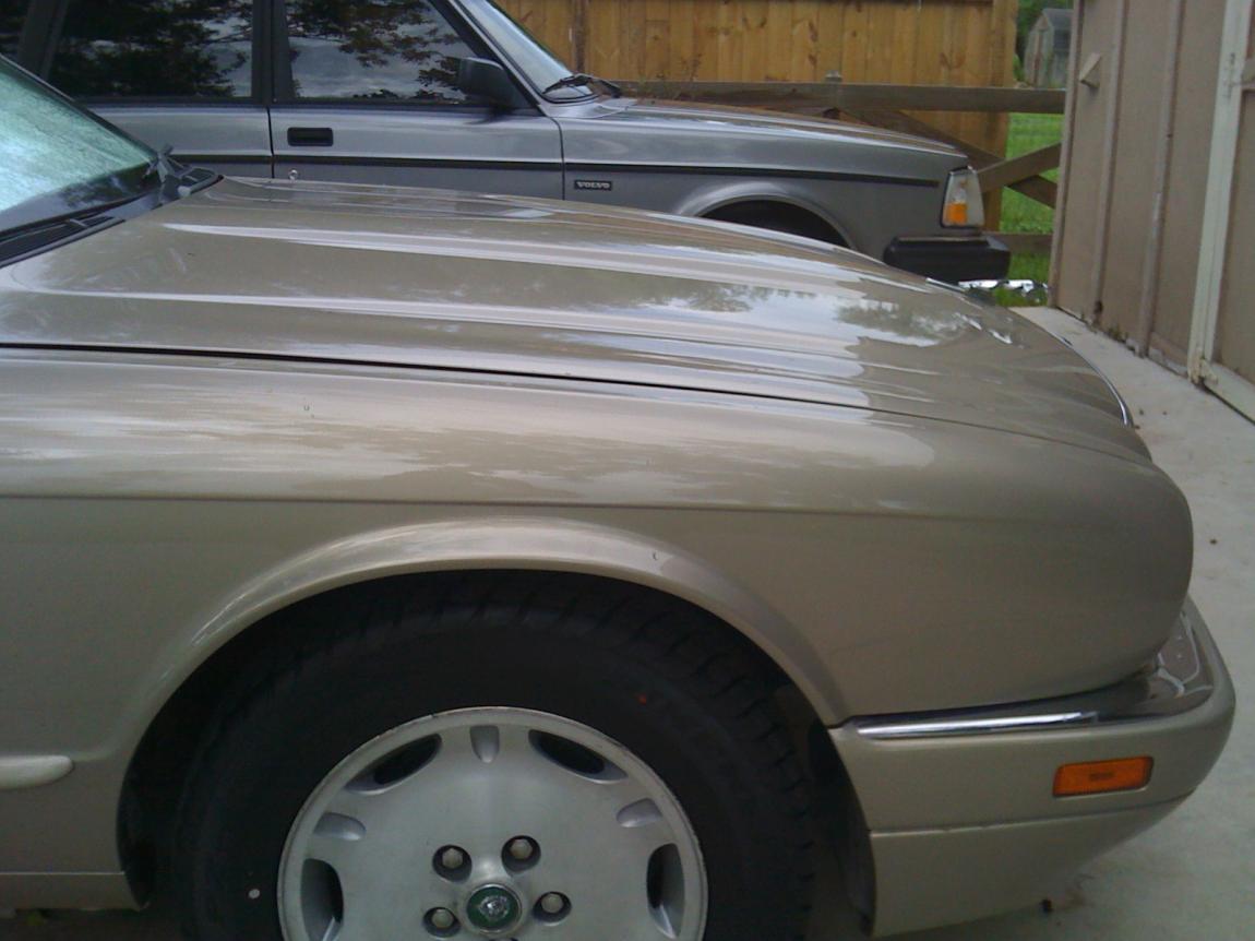

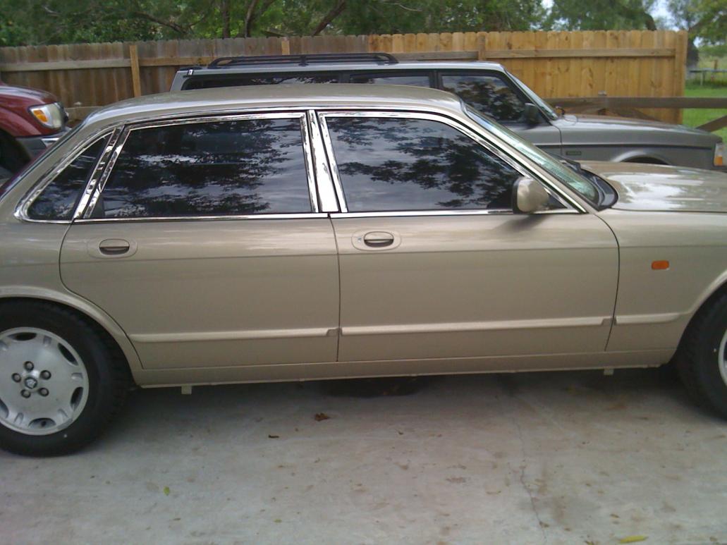

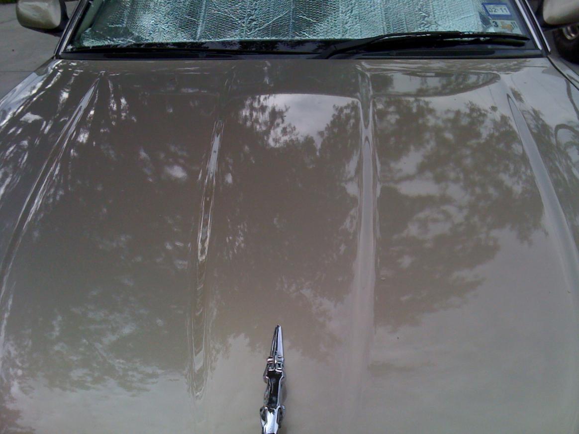

I finally took some pictures of my new paint job on my new Jag X300. Not very good pictures as it has been raining for a week so I held off doing any washing until this weekend. I will get some better pics and put them in the gallery. A question on the picture showing the right front fender and hood. Do you see how the hood does not lie flush? is there an adjustment for this? I took a look this afternoon, but am not sure. Anyways there is the paint. The code is SDN---Topaz Pearl Metallic--hope its close

Your hood needs to be adjusted and I don't think that's a big deal . After a few datailing work to the engine it will look bright and tight lol

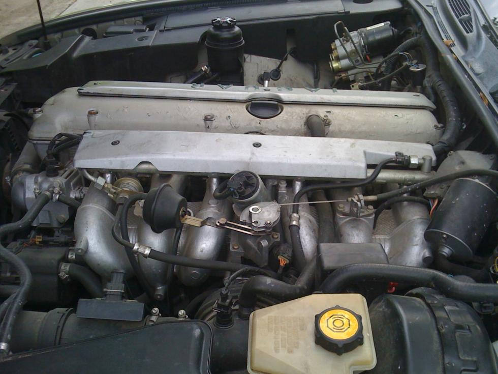

Do you think that hood adjustment is made from the release point or from the hinge? I have always been leery of detailing engines too much. I certainly never wash an engine though I may clean it up a bit with armor-all or something on the plastic parts and the valve cover. Overall I think the paint came out ok. I bought the car for $2600, put a grand into the paint and $500 on the tires. Not a bad investment. I am going to replace the shocks and bushings when I get the cash and I'm thinking of doing my plugs, plug/coil gaskets and probably my plug wires. She starts and idles a little rough/lumpy sometimes---but overall I am pretty happy with the Jag.

I wish I had enough know-how as to hood latch but I think that's more related to hinge rather than cable or release handle .
I would keep it as is rather than power wash any engine bay , a wet towel what I mostly use for such detailing jobs

You can adjust the pins in the corner of the hood. Usncrew the large nut and turn in the post. When you get the right height hold the post with a large screw driver and retighten the large nut.

Drew is correct, you need to adjust the latch pin on the relevant side, These have a triangular tip to locate in the latch, and a spring-loaded keep-washer to maintain pressure to stop rattling once securely latched. Pin can be turned in and out using screwdriver, once the securing nut is loosened off. Does your car have any rubber buffers as well as the latch pins?

Drew, Fraser, and Cadillac, thanks for the input. Without going outside (raining AGAIN) to look, I do believe that there are some rubber bumpers. I will double check tomorrow. The adjustment seems pretty straight forward. Stupid me, I never looked up at the pin. Any comments (tell the truth) on the car from the limited pictures? Considering what I paid, I thought I made out pretty good. Again, thanks for the comments.-----Scott

Sharp car. Paint job looks like it turned out great. Tinted windows pull the whole car together.
