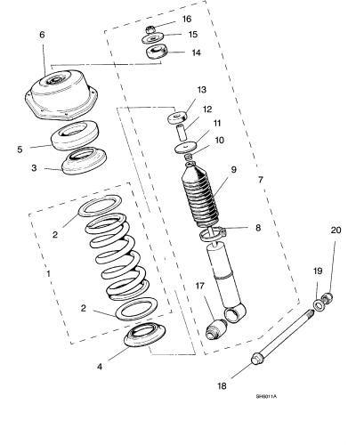

It is possible that one or both road springs on the right side have fatigued and are sagging, but an even more likely culprit is the large foam rubber "donut" rear spring isolator bushing, Part 5 in the diagram below, from jaguarclassicparts.com:
The bushing is over 1 inch thick, and over time the foam rubber deteriorates and compresses, and a corresponding amount of body ride height is lost. The right and left bushes can deteriorate at different rates, so it's possible your right one is worse than the left. And when the rear end sags, it tends to pull down the front corner on the same side due to the stiffness of the monocoque body construction.
Unfortunately, to check that bushing the rear shock/spring assembly must be removed from the car, the spring compressed, the shock's top nut removed and the components separated. If you're going to go to that trouble, you should just replace all the bushings while you're at it (and possibly the shocks, too, unless they're still performing well). Here are links to photos showing the rear shock/spring assemblies on our '93 XJ40, which are similar to those on your car:

I once talked about this issue with many Japanese enthusiasts and a former dealer clerk, all of them claimed the rear right side is a bit lower than the left side (about 15-30mm).
When I drove X300 I didn't care about it at all and I didn't even compare nor measure the height, so I didn't know about my car, but it seems to be the tendency of X300.
That might be because of the large heavy battery in the trunk.
If no problem was found and the RH rear height is still low, you can add spring packers (2 in the diagram Don B provided)
There are 2 part numbers for the packers, one is for thin one and the other for thick.
MNA3562AA 3.4mm/2.9mm
MNA3562BA 6.55mm/6.05mm
In most cases, 1/3 - 1/2 of the packer thickness of the height difference is needed.
If the RHR ride height is 15mm lower, a 6mm packer should be added.
If too many pacer is needed, then of course the original other on the other side can be removed to adjust the height.
