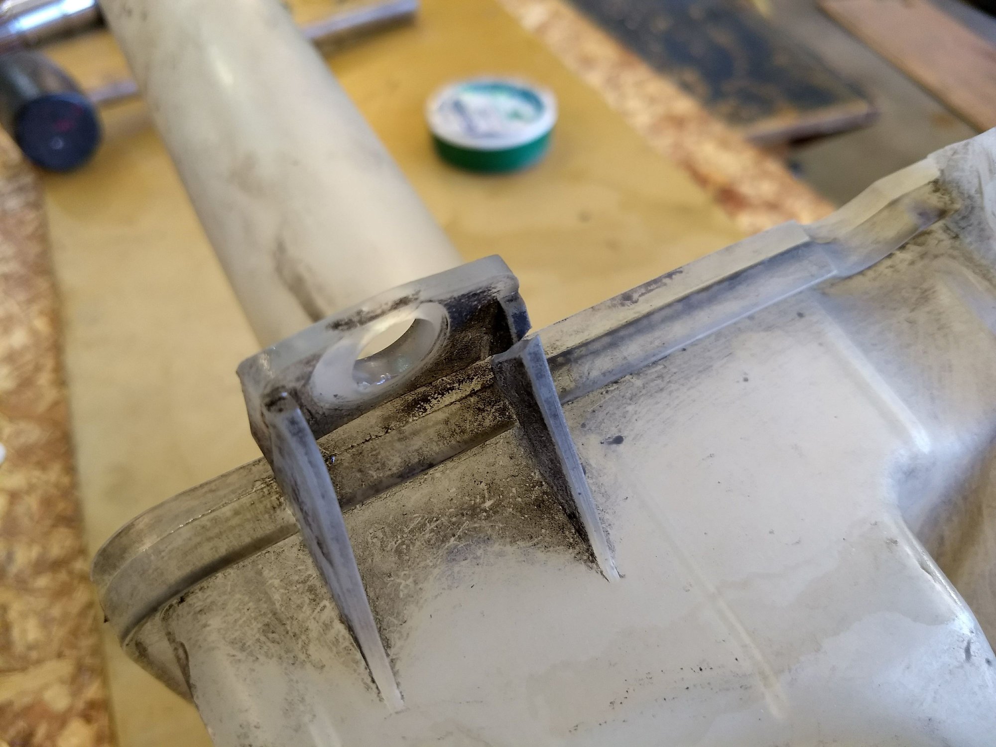

Yeah I saw the post but I found a ne genuine jlm12454 for very cheap and I want to know if it would fit.
Or maybe I can find someone who can repair the broken mounting tabs?

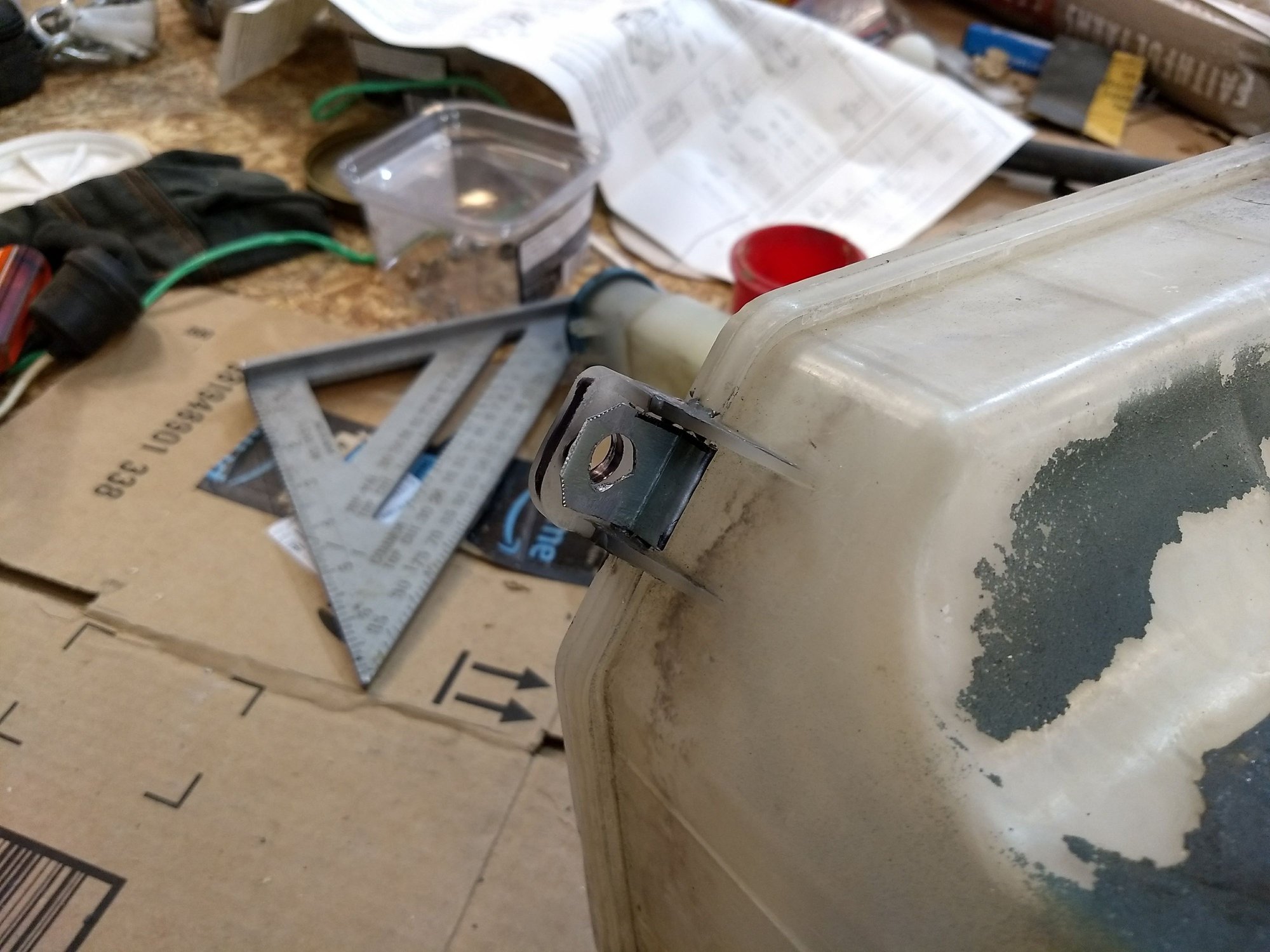

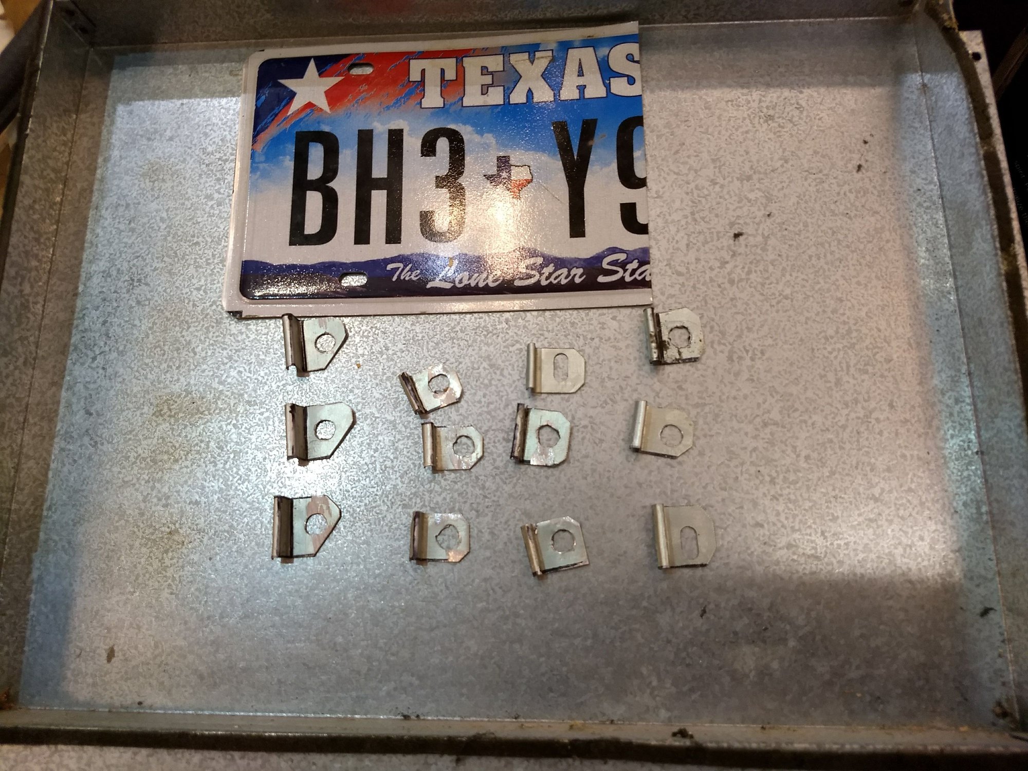

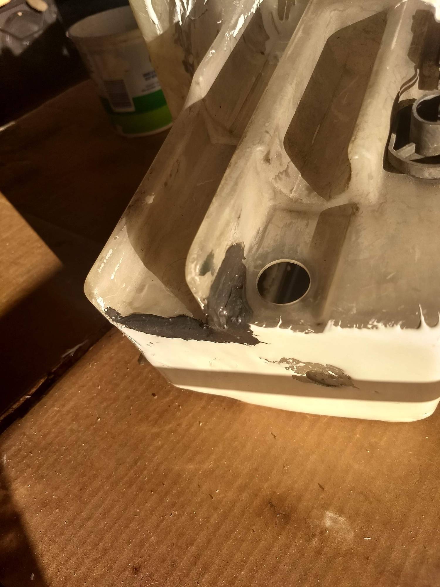

Ahh...just mounting tabs? the bottle is intact? You are only a bumper-remove & Replace + 5 minutes from being whole!
I carefully fashioned reinforcements for broken mounting tabs from an old license plate, resin, and fibreglass cloth....with an eye toward a helpful posting...but during that activity, happened to be on the phone with Motorcarman and described what I was up to, and he said, "Oh.....I"d have just run a couple of plumber-straps diagonally under the bottle and up to the mounting holes...." Made me feel a bit foolish as I'd already fashioned enough reinforcements to do all 3 cars!

It ain't pretty....weren't quick...but it IS serviceable. Like Motorcarman says...just run a coupla plumbing support straps under it. Added bonus, if you do that, you won't even have to remove it from the car, meaning you won't have to remove the pump and sensor...and refit same...during which evolution (refitting pump) I managed, with brute force and awkwardness, to crack the bottle, necessitating an additional remove, repair, and refit step!
