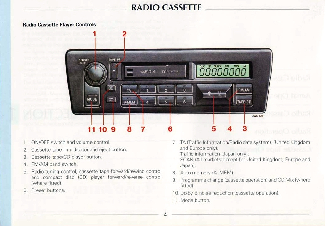

To start getting some help here for you, is this the audio unit fitted to your vehicle?
Is there any telephone equipment (handset or cradle) installed in the centre console?

If your radio is the one shown above try the following. It may sound silly but when mine was acting up by being stuck on one station and at a locked volume I pushed a cassette in then ejected it and all functions worked. Try holding the eject button in for a couple of seconds. I know I've read that others have had the same experience with the eject button "unfreezing" the radio. Can't hurt to try it.
