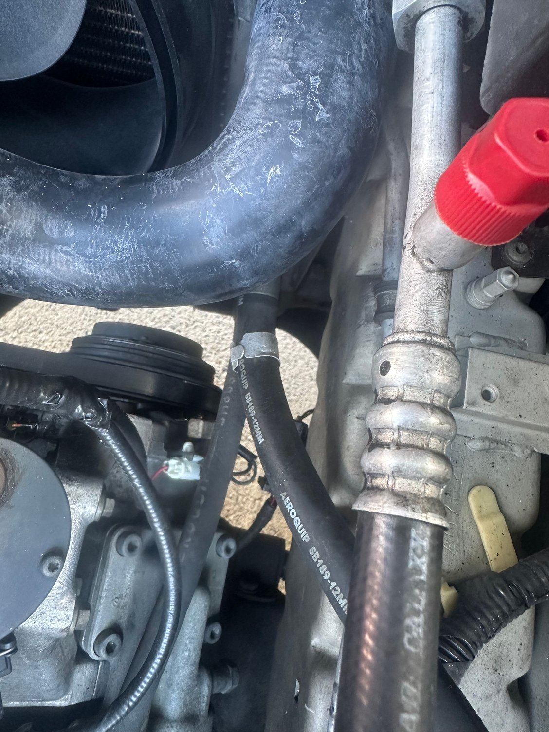

Wha
What is this little hole? Is this normal?
the little black spot on the hose fitting

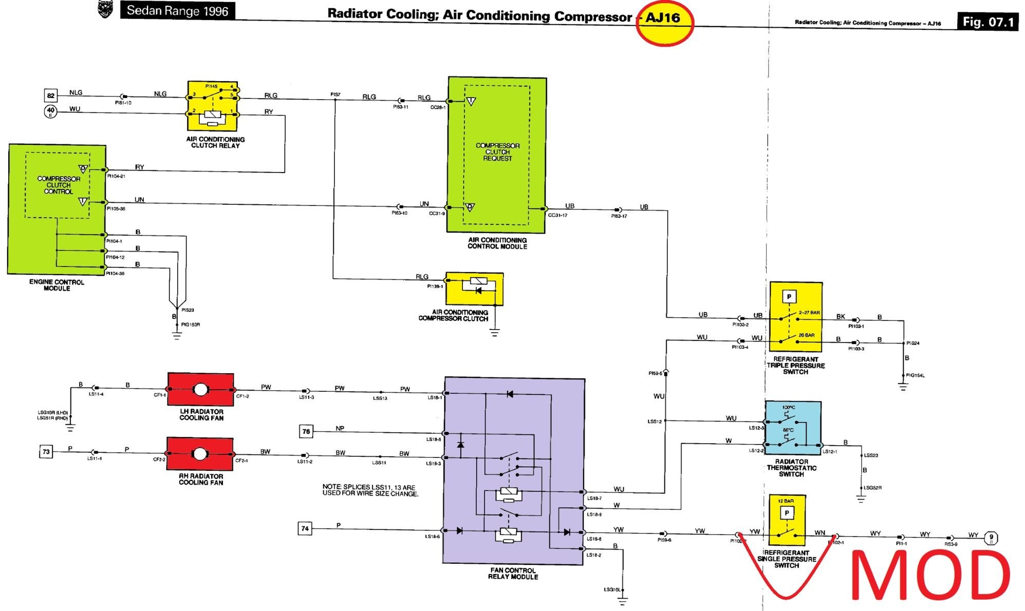

With your finger on the high pressure hose while compressor running does it get hot indicating it is compressing freon
The compressor may disengage by the freon too low switch or freon too high 4 wire pressure switch
If the freon is too high it will engage and pump for a bit until it reaches the too high value
other then that a pressure gauge or crack a line
You are working with missing information and using assumptions although valid of the work done
I see the black dot
The A / C control panel has a freon too low code and how it is determained ..................
The 4 wire freon pressure switch on the 2 - 27 bar contacts m 2 being too low and 27 being too high
Blue / Black wire on the 4 wire connector wire seeing a ground or not , you can knick the insulation
According to the breakout sheet in front of the wiring guide schematic .......................................
Active = ground or no volts Inactive = B+
The A / C ECU on socket CC31 - 17 provides a feeler voltage that is ground seeking
The 13 bar 2 wire pressure switch does not effect compressor engagement but only radiator cooling fan low mode effected by the TSB if done
The 20 bar contact in the 4 wire pressur switch only effects radiator cooling fan high mode

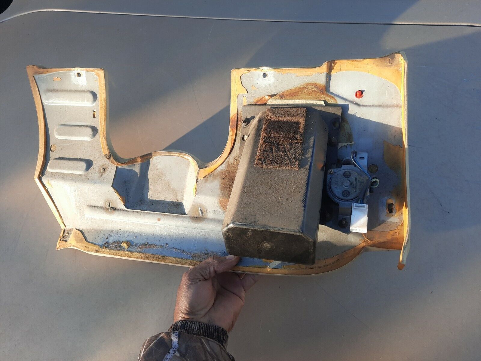

Getting back to your A / C under performance before the shop tinkered with it and lost it
There is a cabin temp sensor that can be clogged with lint and effect your earlier performance and not come up as a system control panel bite code
A clogged sensor will bias the temp signal and not be a failure seen as a bite test
Pics coming
This is under the steering column panel as the small square vent
Clean with air blast only and no solvent ( fan bearing grease ) after removal as you have to get to it from backside and not the front vent

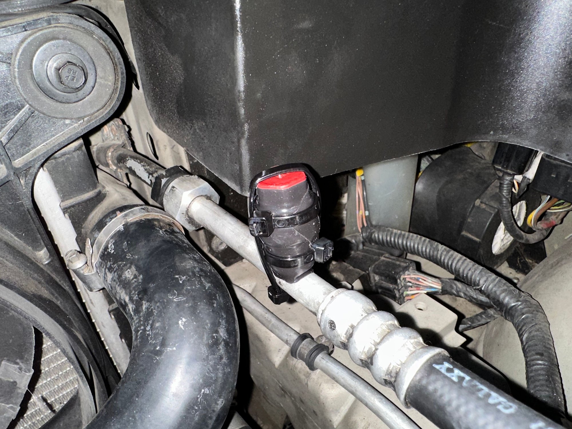

POP!!!!
bamn, the seal in the highpressure fill valve must have given way and it began leaking out of the fill point of the valve....
damn....
he has no replacement there.
anyway, screwed the cap on, it stopped the leak.
got home, wrapped some silicone tape around the valve and lid and put a few cable ties on to help hold the lid securely in place incase the pressure decides to make it blast off.
going to order some replacement valves so I have them handy for when it starts to leak from the fill valve

If the A/C valves on your car are original (unlikely) they may not be schrader valves. In the usual Jaguar fashion, they are different and are in fact a GM design using a special rubber ball valve. The GM part number is 52458184 or AC Delco 15-5438. The valves are readily available and were in fact fitted to some Holden models.
Unfortunately the valve body does employ an 8 sided hexagon which requires a special socket to enable removal. These sockets are available.
A substitute valve using a schrader valve is available.
I have attached a photo showing the relevant valves (original type) and the required socket.

just when looking at my car now i saw a 3rd valve right up near the firewall.
what is this one?
is it a discharge valve or something?
it has a schrader valve in it as opposed to the other two.
