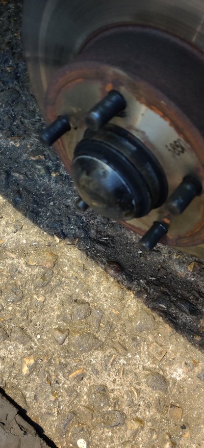

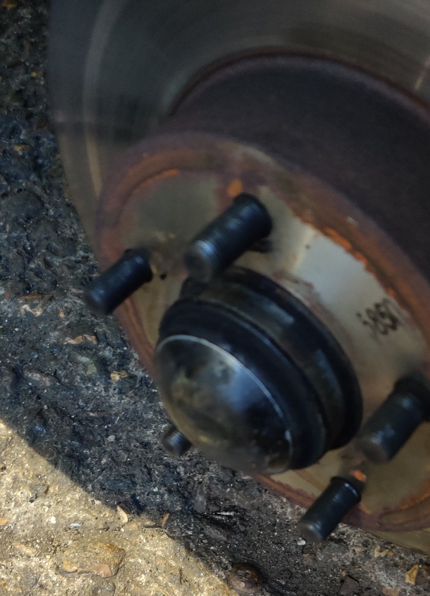

Old Nov 20, 2020 | 07:25 AM
mcc2905's Avatar
Joined: Nov 2020
Posts: 3
Default further detail wanted
Originally Posted by Doug
Are you using Jaguar nuts or something else?
The Jaguar wheels use nuts with shanks. The shanked part goes *through* the wheel to engage the threads on the stud....thus the stud needn't be, and isn't, terribly long.
Some aftermarket wheels use a taper-seat style nut .....no shanks to go through the wheel....which would require longer studs.
Next thought......
Is the wheel fully seated on the hub?
Here's why I ask. I have X308/XJ8 wheels on my 1995 XJR. Perfect fit on the rear. However, they did not fit properly on the front. The front hub is different beween the two cars and the center hole of the XJ8 wheels was a bit too small. The wheels fouled the wheel bearing dust caps and the wheel would not fully seat against the hub. Obviously, then, the studs couldn't possibly protrude through the wheel far enough.
A field modification to the wheel bearig dust caps put things right.
Dust cap X300
X300 front bearing dust cap
DD
I appreciate this is an old post but I have exactly this problem, I have attached photos which show after fitting new wheels(you will note that there is a silver line which is where the alloy is binding on the dust cap. I am hoping someone can suggest how we carry out the "field modification" or is there a different shaped dust cap available?
Old Nov 20, 2020 | 10:44 AM
countyjag's Avatar
Joined: Oct 2014
Posts: 1,092
Likes: 539
From: Scotland
I think Doug was being prosaic when he mentioned a field modification. I seem to recollect from somewhere that a hammer is involved....!
