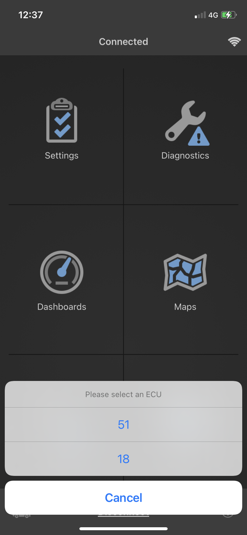

Also for those who have the OBD fusion - do you know what this means? Why 2 ECUs? Whichever I select it seems to give similar info.
Plus does resetting the codes also reset the long term fuel trim? I thought it should but mine still reads 50%!!
Any ideas?

No. Resetting codes will NOT reset fuel trims. As far as I know, ONLY the PDU can reset long term fuel trims, however that's just a running average of the short term fuel trims and does not affect how the engine fuels the car in any way. It's simply a way to zero out that average to help figure out if you've solved an over/underfuelling issue.
As for the ECUs, I believe it is asking you between ECU and Transmission ECU. When I have some time, I might be able to research this further.
