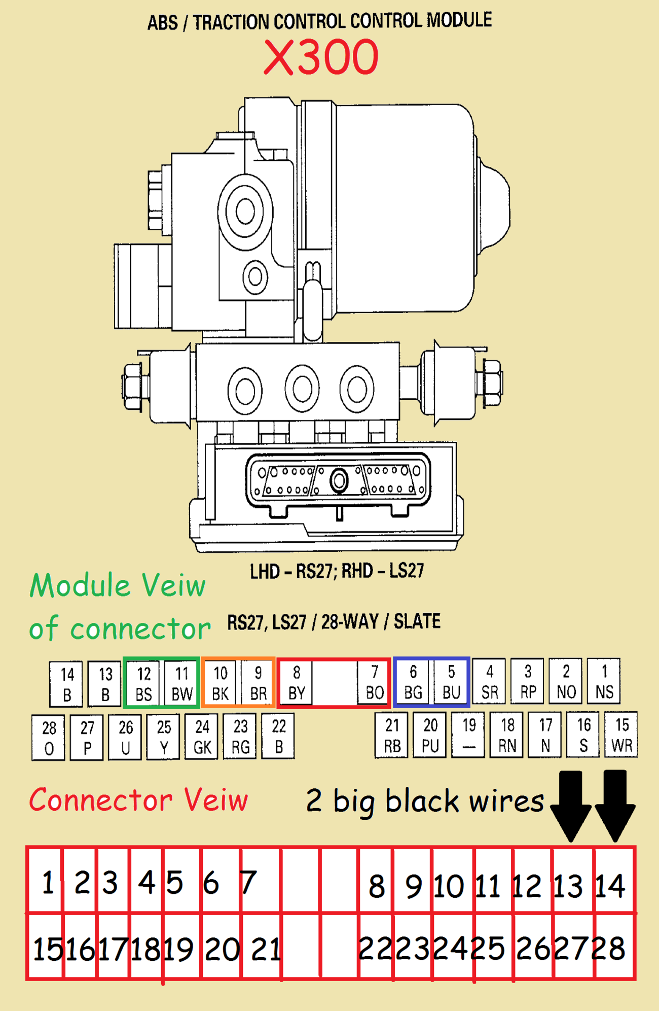

Least getting it out it will read 1300 ohms resistance as a fundamental reading
A functional reading would be about 1 volts AC if you spin the tire in the correct direction
You can do this test from the ABS module up front under the hood
Left rear is pin 9 and 10
There is a knuckle in the way so you would have to rotate the rear wheel to get a clean shot on it

Do an electrical meter check before you commit to removing the sensor
You can compare your meter readings including the wheel spin test against the other wheels as I marked them as color pairs in the module connector pic

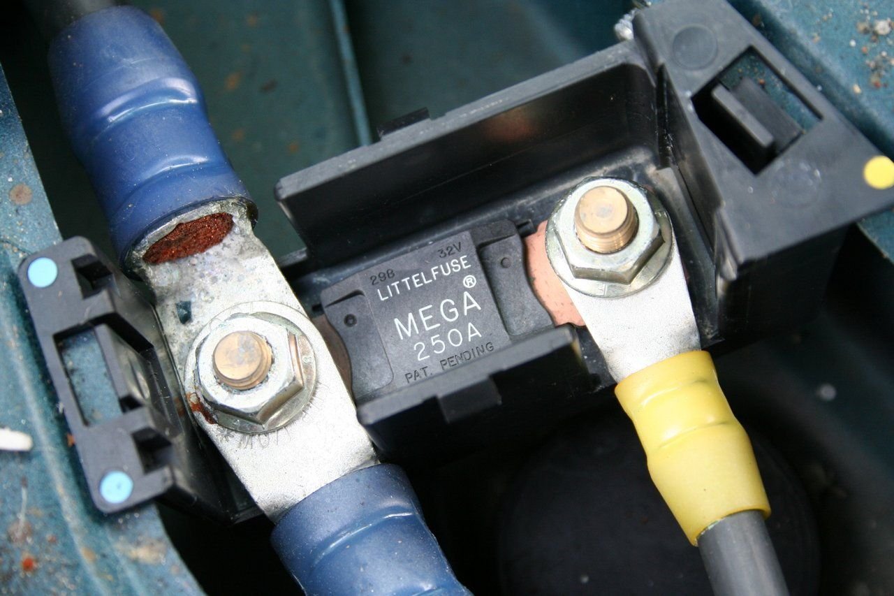

Might as well as having the lower pan out ensure on the car's right under a black plastic triangle that the battery cable terminal nuts are tight
