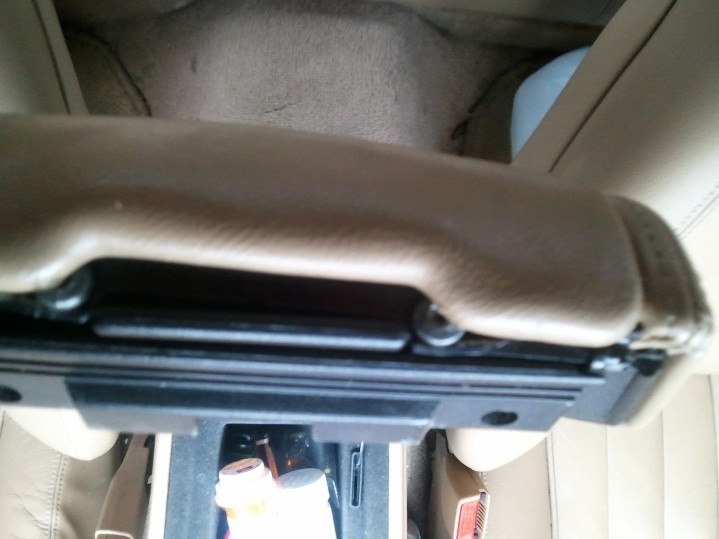

I screwed mine shut. Problem solved. 2 screws, one on each side of the latch.
Attached Thumbnails Anyone glued their cupholder lid shut?-wp_000024_zps391f88de.jpg
