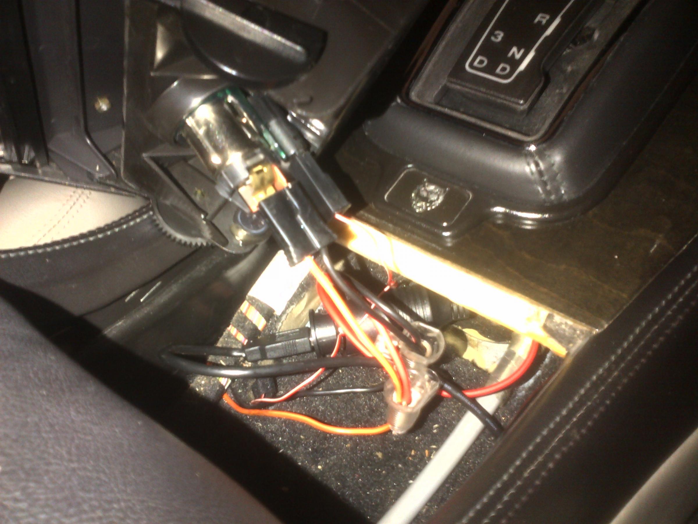

My aux lighter socket finally arrived (much patience required when ordering a $2.25 item incl. postage from China!!), so the job is now finished. Pics as follows (my car is obviously RHD):
1. The first mod. was to simply plug the USB charger into the stock lighter socket and plug the cable leading to the USB hub into it. Neat enough, but didn't look too original if the ashtray lid was flipped open. Not that anyone smokes in my car, but it just niggled me that the original appearance was disturbed!
2. Spliced the new aux lighter socket into the existing wiring beneath the ashtray, and then plugged in the charger, and the main USB cable into that
3. Original lighter wiring terminals back in place
4. Lighter reinstated as original, looks more satisfying to me
5. USB hub positioned under the steering column, connected to the main cable running from the aux lighter socket, under the console and kick panel
6. I previously had the USB hub mounted on the outer surface of the kick panel but cables were still exposed. Now it sits tucked within the kick panel area under steering column
I have only the dash camera and GPS connected at present and the wiring for those is totally concealed beneath various trim with the cables emerging at the kick panel area to meet the hub. The hub easily pulls out if I want plug in up to 2 more devices.
I'm really happy with the job now, hope this helps someone else!
