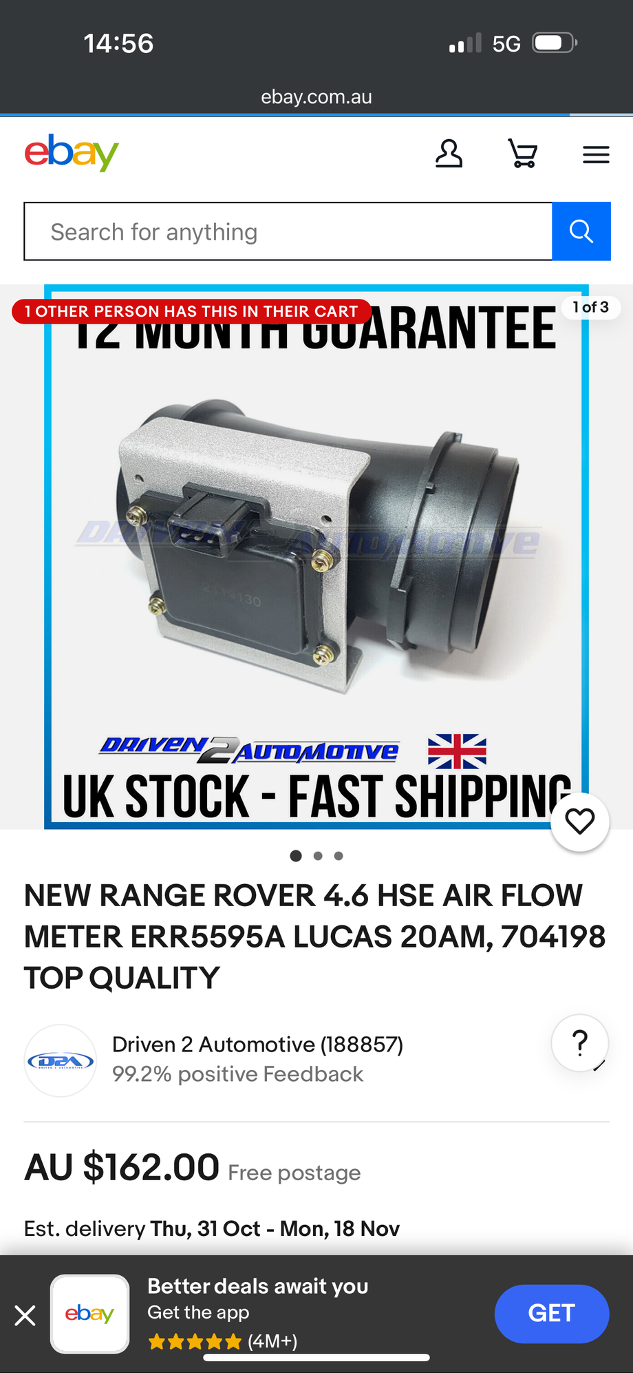

This is same yeah? Lucas 20am?
looks decent price.

Looks the same , minus Lucas placard , legal line in sand
Chinese copy ?
There is a E mail link to seller and the origin is on the description part on the E - bay page
You can take apart and see if one of your originals has silicone migrating into the circuit board , now how do you remove the silicone ?

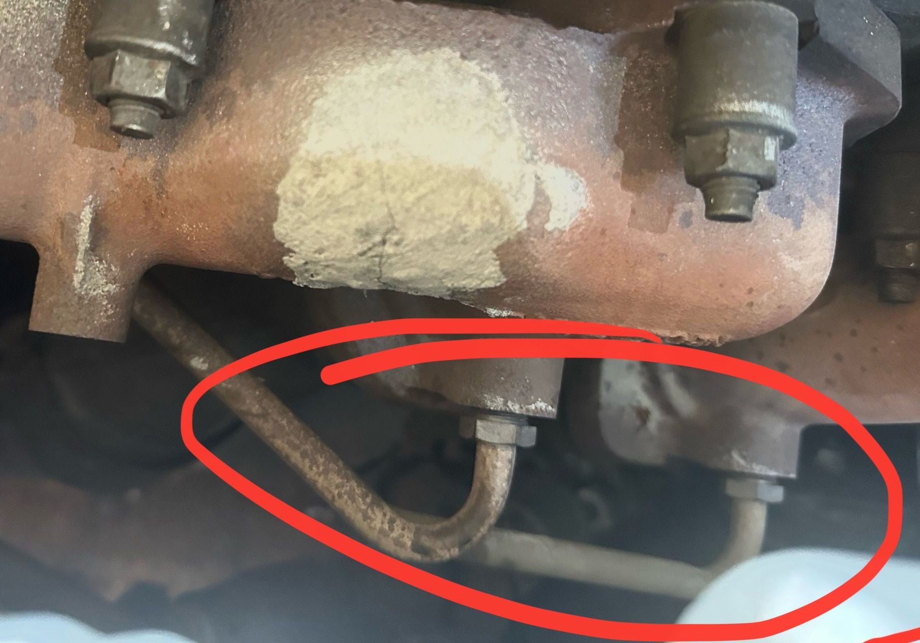

could the secondary air pump have anything to do with this?
i have absolutely no idea what it does or how it works...
also out of curiosity what are these two lines and what do they do?

EGR or smog pump
I wouldn't take the line in the red circle off
More later when I took mine off

Those lines go back to the EGR.
Regarding the secondary air pump, "Air injection is used to promote reaction in the exhaust down pipe catalyst, reducing the time required for the catalyst to reach working temperature. The air pumped into the exhaust manifolds mixes with exhaust gas and oxidation takes place. The heat generated in this process reduces the time required for the catalyst to reach operating temperature. Air injection is enabled by the ECM following each cold start and remains on until the engine coolant temperature reaches 95°F (34°C). At 95°F the air injection circuit is switched off and closed loop air / fuel ratio control is enabled. If the engine speed exceeds 2500 rpm while air injection is enabled, the ECM will switch off the circuit.
On 1993 – 94 MY vehicles, air injection is also enabled for approximately 30 seconds after each hot start.
The ECM switches the air injection relay, which in turn switches both the air pump clutch and the air injection solenoid vacuum valve. The solenoid vacuum valve controls the vacuum signal to the air switching valve. The air switching valve performs two functions. It backs-up the air injection check valve and it prevents air from being sucked through the pump and check valve into the exhaust. Such leakage would cause an air / fuel ratio error at the oxygen sensor. The vacuum supply to the air switching valve is sourced from the intake manifold through a delay valve. The delay valve is used to ensure that the air switching valve is held open during short periods of high engine load.
The ECM monitors its output to the air injection relay for on-board diagnostics."
Can you verify that the air pump comes on?
Do you know where the Air Pump Relay is located for your model year?
Your model year happens to have an Air Switching Valve located behind the air pump. It works via vacuum. Perhaps the vacuum tubing has ruptured? Can you locate that valve and check the vacuum tube?

They must be the lines for the secondary air pump.
we don’t have egr like the US market does
Unless i have been given fake info all this time
no idea how to check anything on the air pump.
will do some looking around and see

Since you do not have EGR valve ( located top of intake manifold between cylinder 3 and 4 you could have the exhaust manifolds for being EGR installed and they capped the lines , mixed manifolds not in stock as they manufactured the whole engine / car ) , there is a EGR temp sensor with 2 wires nearby located on top nearer to the engine block
The secondary air line is the very back of the back manifold pointing aft as a flexible aluminum 1 inch line that is not rated for EGR gas heat drawing off the exhaust , you can check the exhaust manifold clamp is tight and the flexible thin aluminum skin tube is not compromised as posable
If you pull off the lines in your red circle it has fine threads and the lines are not a perfect shape / off angle to reengage the threads

When i get a chance i will do some looking and follow those lines.
i know they run around the back of the block and then dunno after.
and also look at the plumbing regarding the secondary air pump
