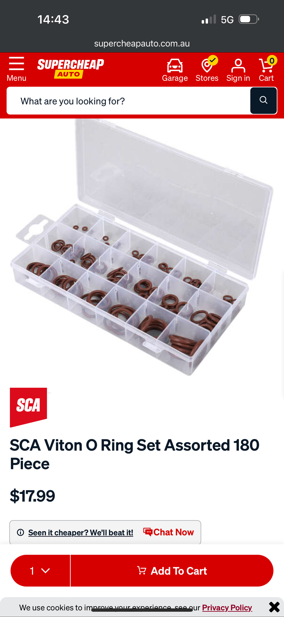

question.
does anyone know the injector o ring size?
and are black nitrile o rings ok for fuel?

Parker 7's Avatar
Joined: Aug 2021
Posts: 4,653
Likes: 1,318
From: Kansas City
Green and I wouldn't trust a E - bay seller as that important , get from reputable source least engine fire
I've seen them at the local auto parts stores
Don't forget to use fuel seal lube or they can roll but the small size diminishes that , vasoline ?
don't forget to do a leak check by stuffing around the area with paper bags , shows leaking fluid as dark stain , or foot talcum powder
When lifting fuel rail be careful of it not getting away from you as it pops off a stuck injector least bent rail , there is a trick to not leveraging off the brittle magnesium valve cover lip

How bout red?
Old Oct 9, 2024 | 11:30 PM
  #117
Parker 7's Avatar
Joined: Aug 2021
Posts: 4,653
Likes: 1,318
From: Kansas City
Things are color coded for a reason unless.........................
