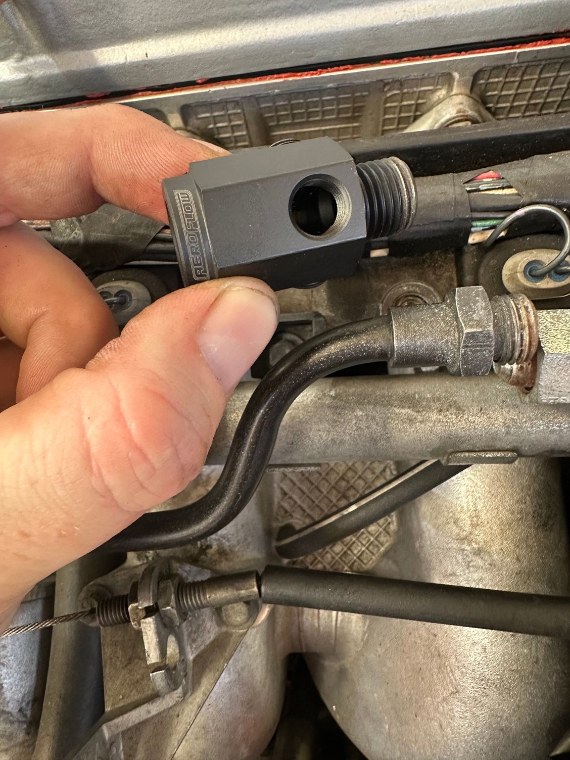

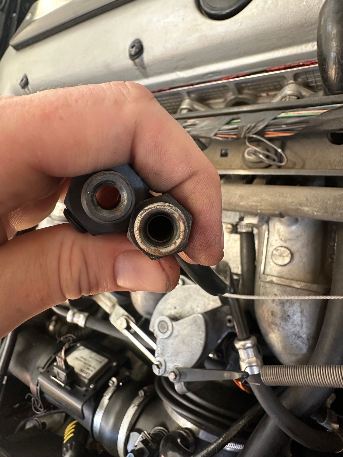

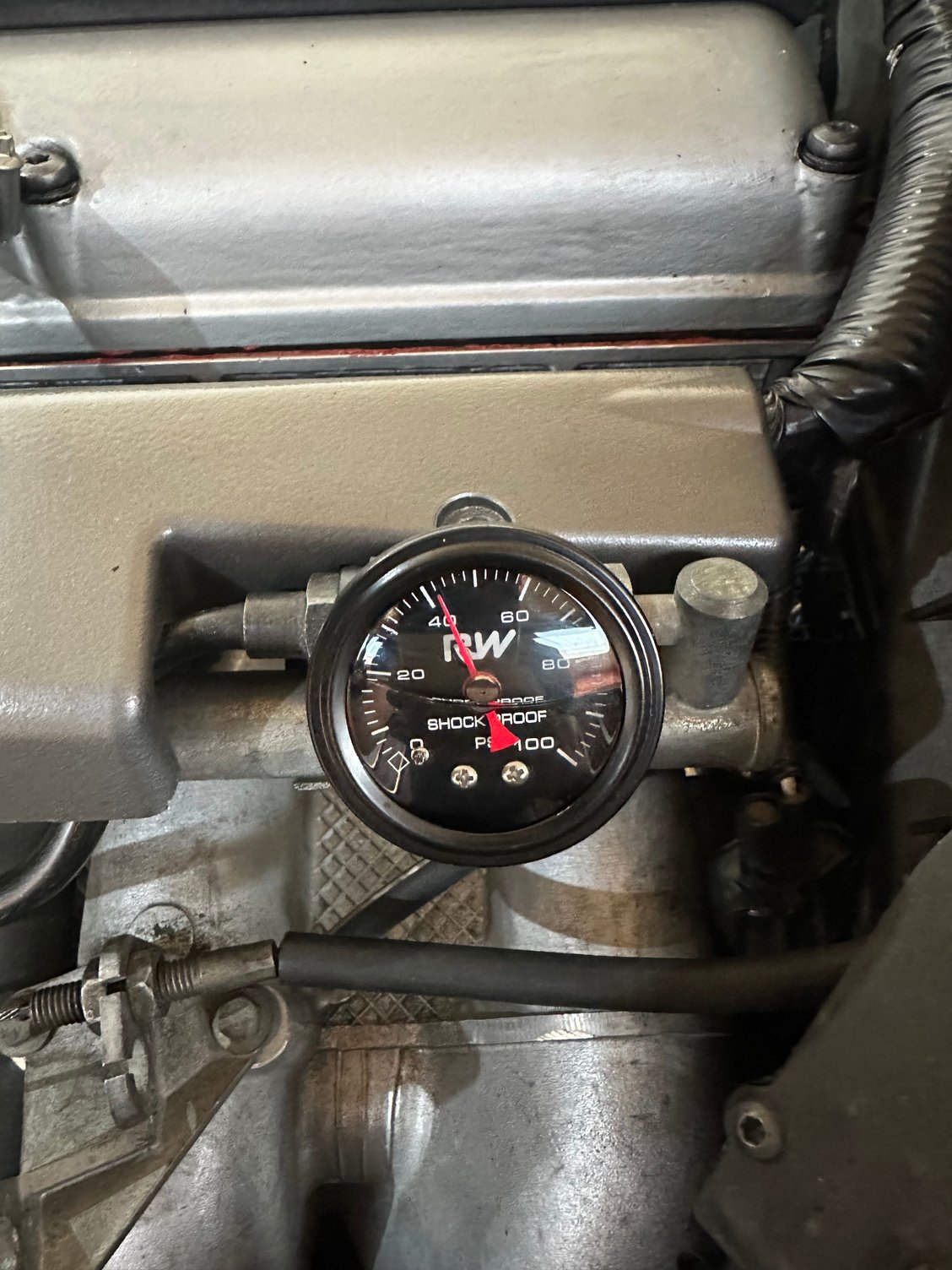

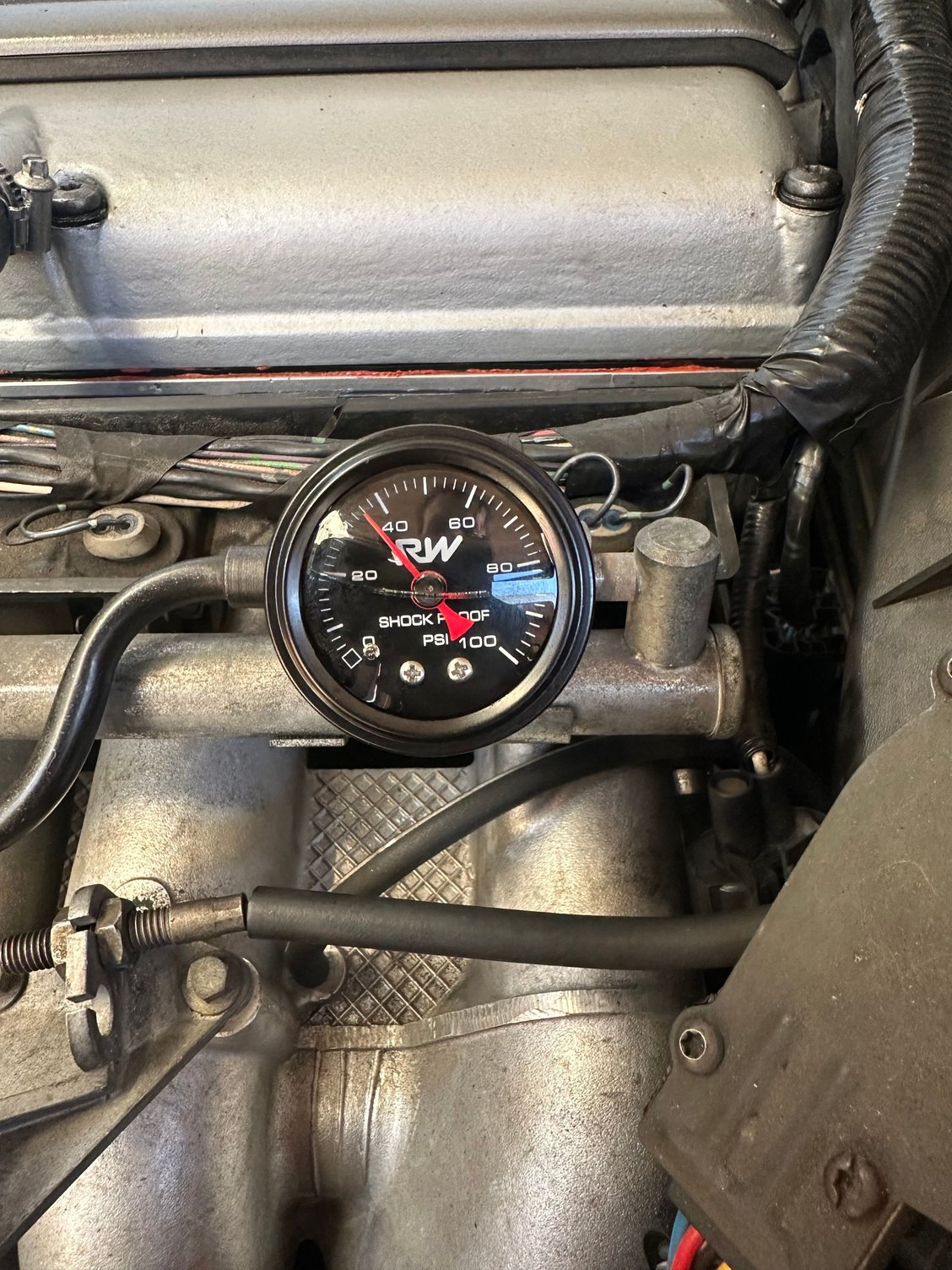

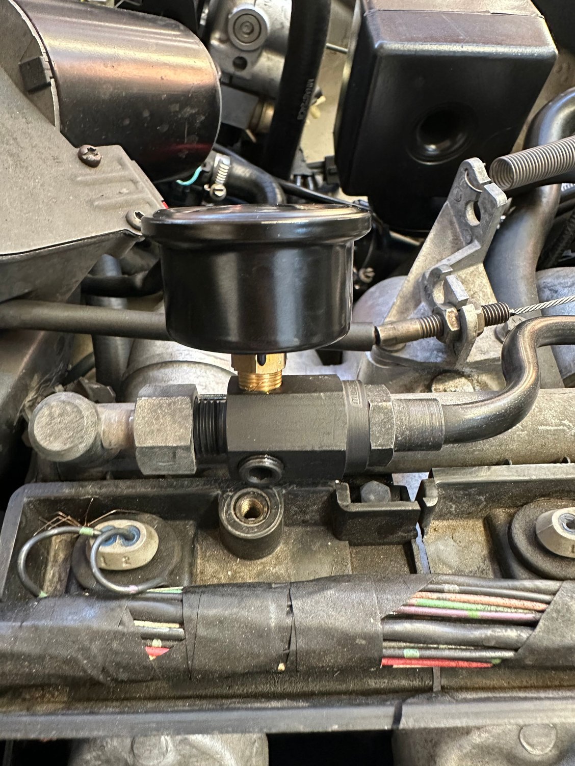

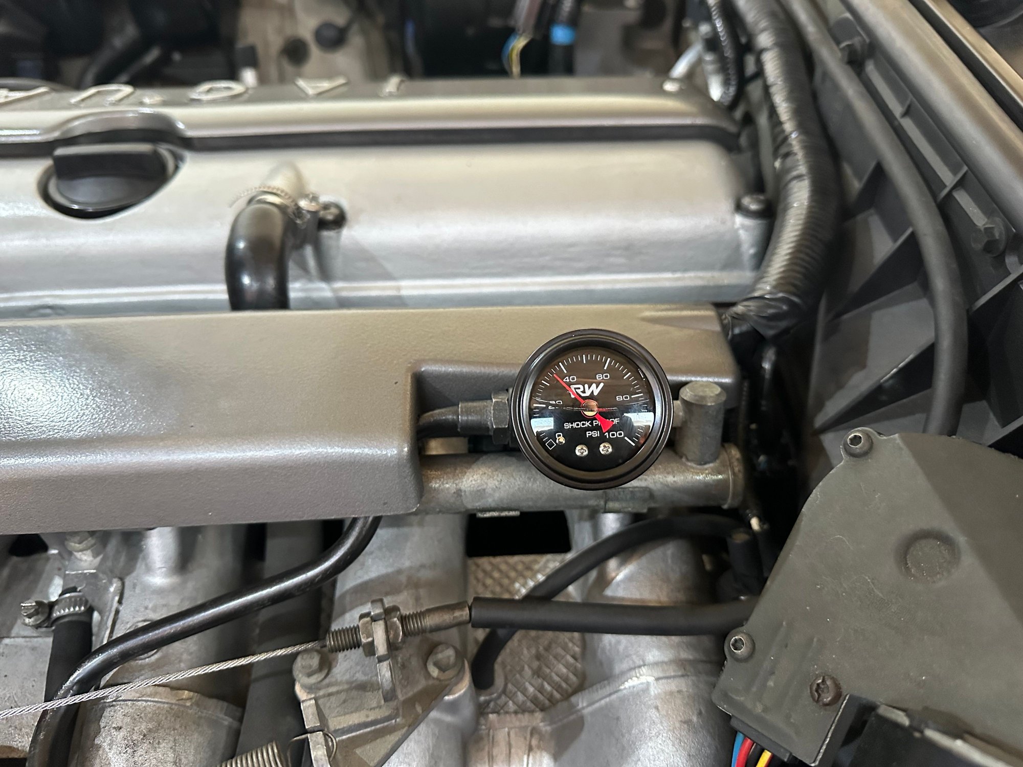

Ok…..
so installed a fuel gauge…..
adapter threads perfect.
chamfer on inside of adapter is a little smaller so it doesnt go on the rail as snug as i would like but all good.
but fuel pressure seems low when running
only about 36psi.
when car is off fuel pressure is ok. About 42psi
Not sure regulator, pump or injectors or all.

Neat job.
Where did you get the gauge and adaptor?

got it from a place online here. automotive superstore.
here are the links.
not sure where you could find the adapter over where you are.
the only thing that could be better is if the chamfer opening was a little larger on the adapter it could sit on a bit deeper and allow a couple more turns on the nut.
i am going to get some PTFE tape and put that on the threads just to be 100% safe and secure.
i had to cut a little off the plastic fuel rail cover and that rear bolt no longer goes in the plastic cover.
but that really does not matter.
https://automotivesuperstore.com.au/...gaArJkEALw_wcB
https://automotivesuperstore.com.au/...caAjhPEALw_wcB

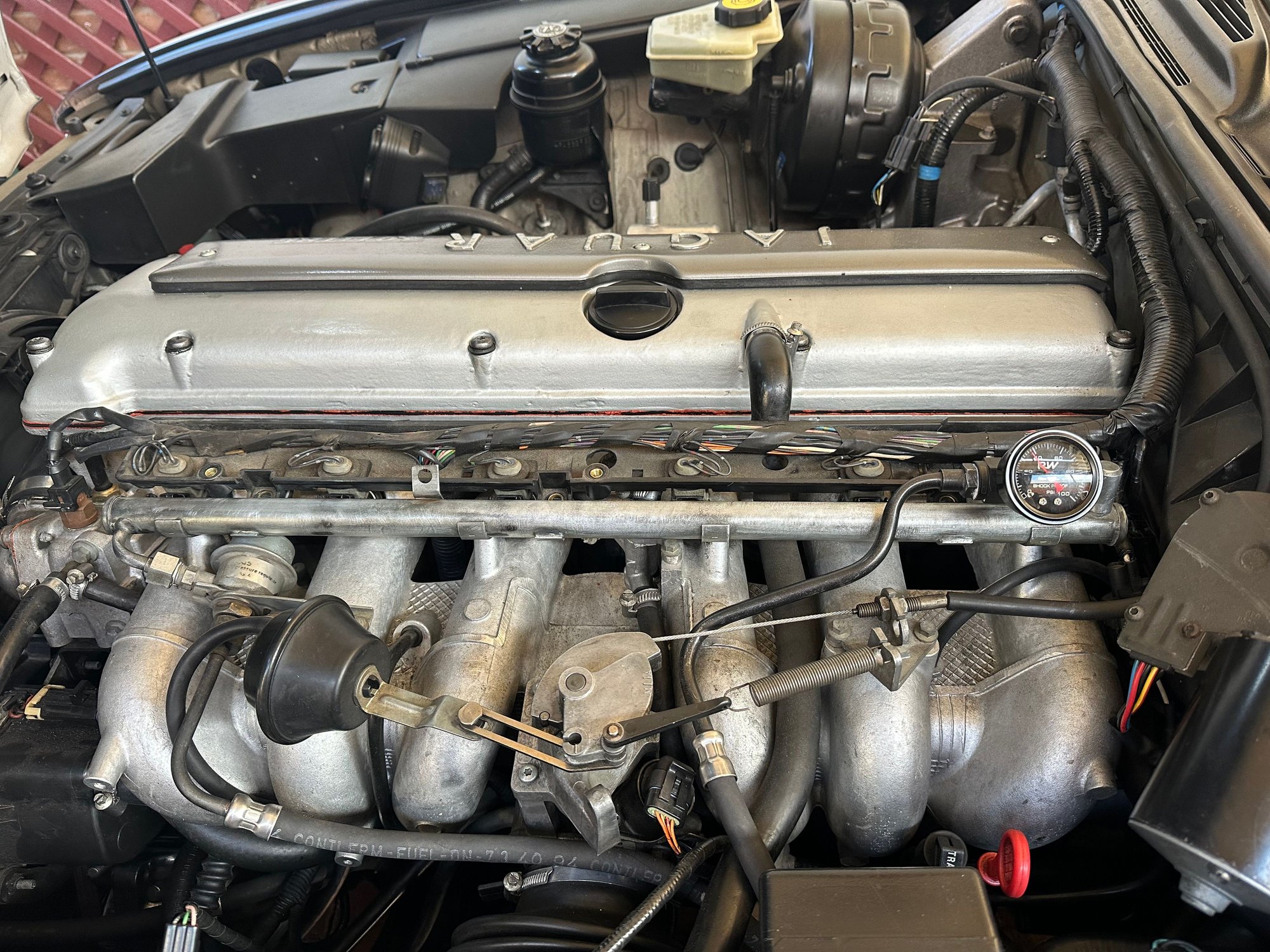

That is a correct placement for the gauge
To improve the fuel pressure to 43 psi idle and 46 - 47 on throttle up per manual spec :
Main fuel fitter change , but easier to jumper the fuel pump relay socket 3 to 5 with good current passing jumper
Use medium gauge wire or double up smaller wire using blade type connectors for better socket contact
You can siphon most of your fuel out of the tank with a 1 / 4 inch X 6 foot hose cheaper from the large spools at the hardware stores
Some X300s do have a siphon trap way down in the fill neck , but mine does not
The final bit of fuel you can jumper the fuel pump relay with inboard side fuel line into jar
New filter arrow / flow points outboard , look for O - rings down inside filter fittings
Inspect the on the fuel pump motor connector for burnt sockets
II don't know if the gauge will clear the bonnet on closure

The gauge does clear the bonnet.
i wanted it a little lower than it is but all good.
i think maybe it hits on the bonnet lining.
here is a video.
there is 2 clips in one.
the first 5 seconds is on initial startup today.
was 38psi on idle and then up to 42 or so on throttle.
second clip is after my drive when i parked at work.
was 36 initially, then you can see it behaving correctly climbing on throttle, dropping on release, etc.
it does then rest a little low.
on throttle it is getting to 44-45psi which my understanding is correct as these injectors are 43.5.
so maybe no issue here?

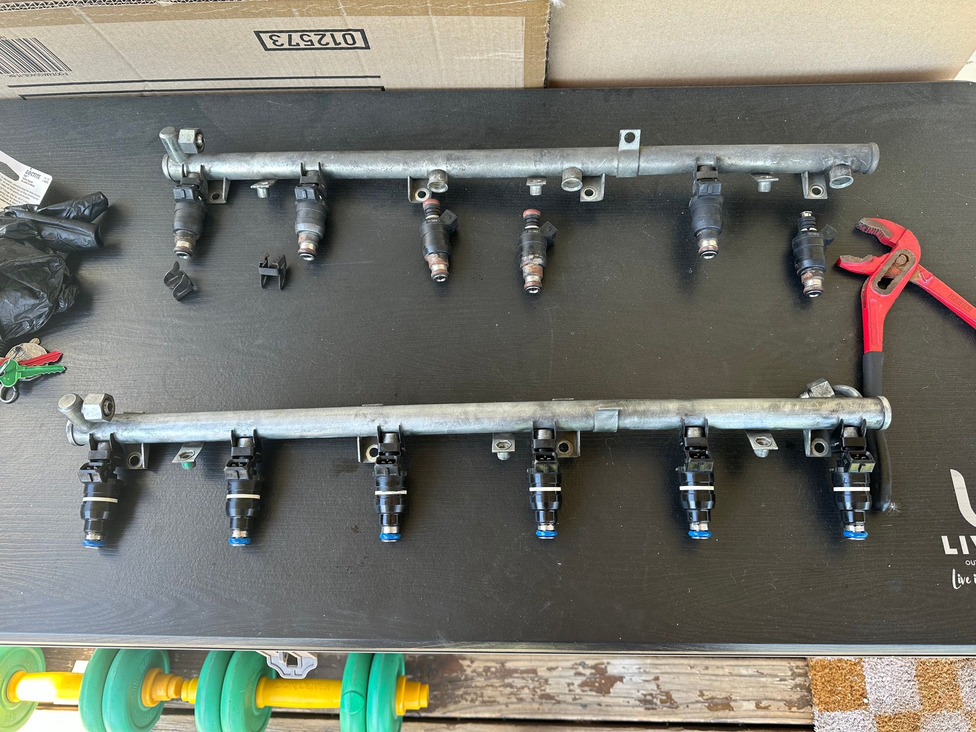

GOOD NEWS EVERYBODY!
so i took the injectors from the parts car,
ultrasonic cleaned them, replaced the micro filters and o rings
put them in.
cleaned the fuel rail while i was there…..
and now. Fuel trims look much better.
will keep an eye on it.
if anything bank 1 is now running leaner than bank 2 which shows me the ecu was trying to compensate for a leak.
I hope my problem is now sorted.
will bench test the old injectors and see.
it should now sort itself out. Very happy!!!!
then old injectors look as tho they may never have been cleaned.
