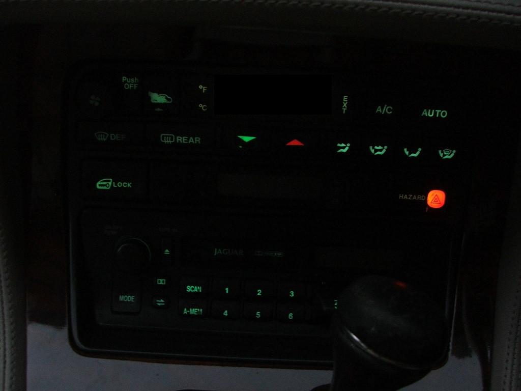

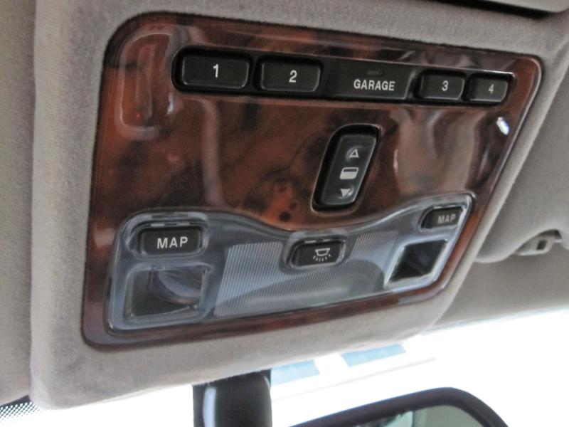

I thought I was pretty clear, it's only the backlights for the buttons on the stereo, window controls, garage opener, and dash (very very very faintly).
Every light in these pictures, except the LCDs which I have blacked out, stay on after the car is off and locked, and remain on until the battery is dead.
Attached Thumbnails Battery dead in morning,  lights not turning off? (urgent)-y0wpw.jpg   Battery dead in morning,  lights not turning off? (urgent)-95-96-97-jaguar-xj6-vanden-plas-x300-driver-door-window-mirror-switch-w-memory_151698597275.jpg   Battery dead in morning,  lights not turning off? (urgent)-xjr-walnut-sunroof-console.jpg
