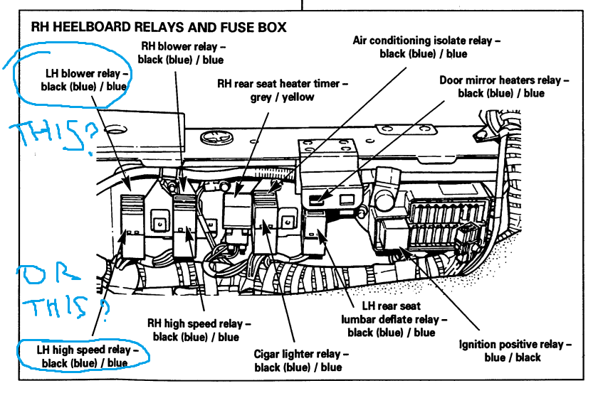

By rear you mean the rear of the two left blower relays under the rear seat? If you take the front one out blower still runs?

Exactly - When I pull out the front relay, nothing happens. The fan continues to run at full speed. When I pull out the rear relay, the fan stops.

Front relay gives direct ground to the blower motor so it runs full speed. The speed control box brings modified ground depending on what speed is requested by climate control panel. So if you remove the high speed relay and the blower still runs at full speed then my guess on speed control failure looks legit. But the climate control fail also shouldn't be excluded. BTW if you switch the climate off does the blower run?
Now it depends on what is easier for you - obtain the working panel at least just for the test (as its easier to replace and will confirm what is failed is it panel fail or not) or try to reach both blowers and swap the speed controls on them. Should you be in the US i would gladly borrow you the control panel as i have one spare.
