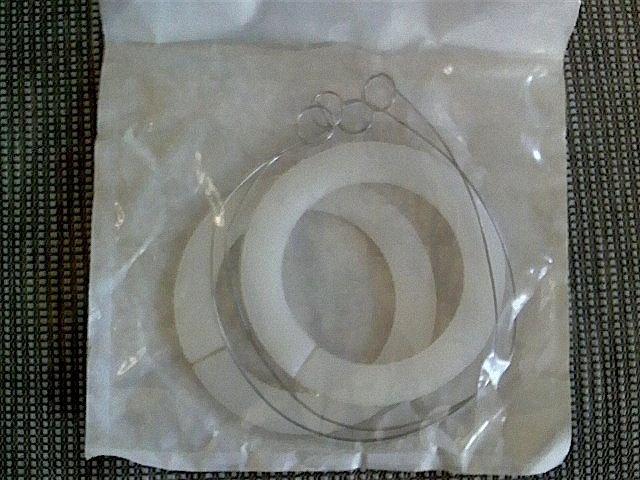

Leaking ? Seal kit avail and should only need outermost seal ( 2 ) , there is a thing where the hoses at the bottom of the fluid reservoir leak at the clamp going everywhere including rack throwing you off
