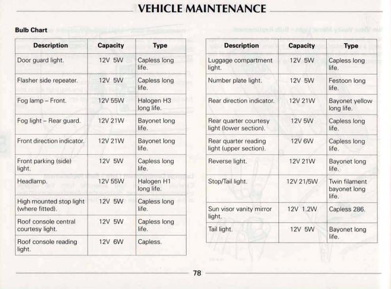

Is there a list floating around of the bulb sizes for the exterior lights around the vehiche? parking lights, indicator lights, brake lights, etc... I've been paging through the maunul and can't seem to find anything. I'm hoping to purchase some replacements online. car is a 97 xj6. thanks

Is this what you're after:
It's from the Vehicle Care Handbook.
