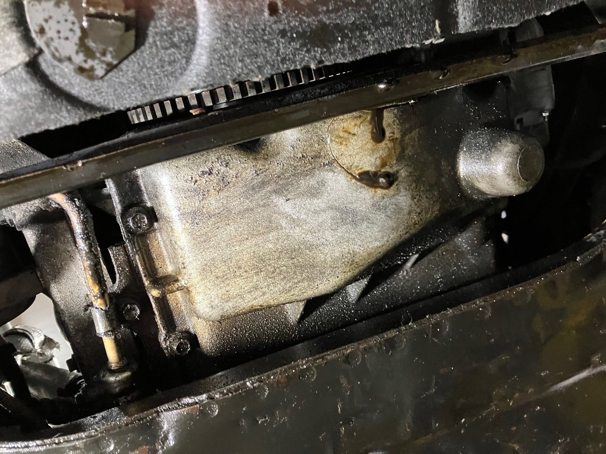

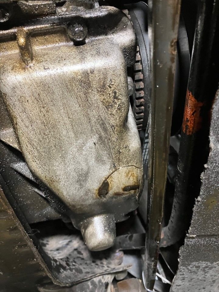

My obsession with the XJR6 ended a few days ago, because I was in total pain when Rose, my 1995 XJR, suddenly died due to a mysterious loss of engine oil. She was under normal daily use when suddenly I heard a louder than normal engine whine and saw the oil pressure indicator jumping up and down, and before I could find a gas station to look at the oil level, the oil level low warning light lit up. I knew I should stop the Rose immediately but down under I knew it was all too late so I drove slowly for a few miles to finally stop at my nearest known workshop. They found almost no oil left and a huge circular crack extending laterally and vertically in the oil sump pan behind the steering rack and under the harmonic balancer. The team excluded the possibility of a hit from below as there musts have been an extraordinary noise which would not escaped undetected, and the spot where the crack was was well protected by the cross beam and steering rack. Metal fatigue was the only explanation. See pictures in the next post.

Forgot to post a picture showing the location and shape of the mysterious crack found in the oil sump pan housing. Here they are.
A few years ago, a broken Champion spark plug in the spark plug well blew one of my Made-in-Japan coil packs left me dumbfounded; this time the oil sump pan is another sign, so it is time to pass and move on. Whatever, this forum has tremendous technical resources and wisdom that helped keep Rose on the road and made her shine in the boring roads in Hong Kong - she will be remembered. Hopefully she will be reborn some day. A Jaguar enthusiast in Hong Kong has just taken her home and will see what he can make of Rose and Gabby. His current collection in the Jaguar series includes an X-Type 3.0 AWD, a Daimler Super Eight, and an X350 XJR.

Sorry to hear of this incident and that you off-loaded the cars already. Was there no hope of a transplant from Gabby into Rose?
The damage to the oil pan looks like an impact. Did you have an undertray in place? Maybe that was an old impact that finally cracked open?
Are you certain it wasn't an oil cooler hose that burst? Too late now anyway but whatever the cause, any engine run without oil for too long (not long) will let go in terrible ways. In 2017 my XJ12 luckily escaped any engine damage due to a burst oil cooler hose. I stopped the car and engine as soon as I could, which took some seconds as I was cruising on the freeway at the time!
I always admired your XJR and your dedication to it. Hoping there will eventually be a Rose Bronze AND a Turquoise XJR on the streets of HK! On to your next project and good luck.

I am sure that Rose could live on a donor engine from Gabby, but having done so much work on Rose, I just thought it was time to pass and let someone have a chance in managing the recovery project. My contingency was, if no one came forward within three days after my posting them on Facebook, I would just put Rose and Gabby away for some time before I regain the will and energy to work on them again.
About the engine splash guard, a few months ago, I saw it slip away when Rose was cruising on the highway. I never felt safe without one, but couldn't find one on Gabby so I obtained the measurements from our dear friend Naki and asked a local workshop to fabricate and installed one. This was done during a two-month long tracking of an alignment issues which led to the replacement of the brake pads, suspension and control arms bushings, the vee-mount etc. Then the workshop also worked on a high-pitch squeaking sound on start-up and rapid acceleration. These led to replacement of all belts, pulleys and ilders, generator, water pump and the harmonic balancer. I believe that any pre-existing cracks on the oil sump pan would have been discovered during such extensive work done on Rose's underside. Moreover, had any sign of oil loss emerged earlier, the engine failure could have been prevented. Whatever, this is now water under the bridge. The important thing is that Rose and Gabby have gone to a new home with promising signs of a come back some days later.
