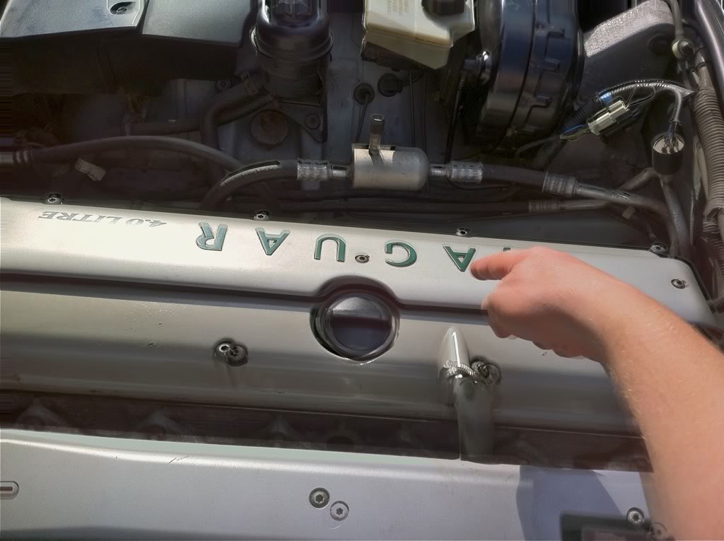

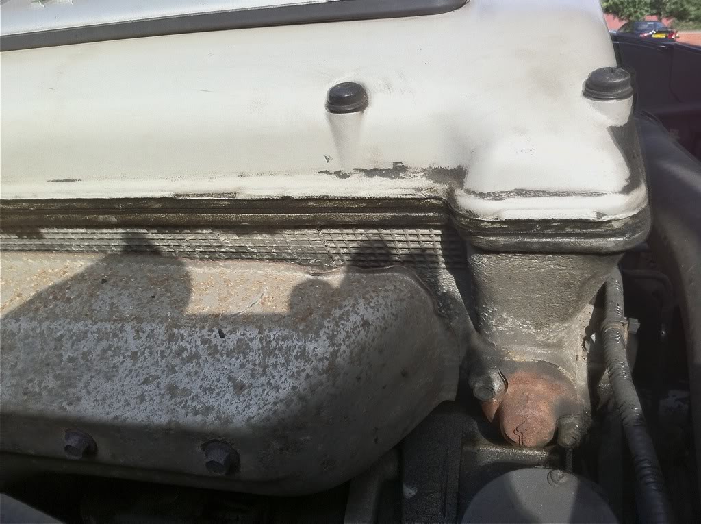

On doing so I noticed I leak down the front edge of the cam cover, see it trickling down:
On the XK engines its so easy 11 studs a bit of wriggling and its off.
Now I now under here is the spark plugs and coil packs does all this have to be removed, I know the cover will have to come off
A few sentences from a man in the know how to change this gasket if some more fiddling is required would be welcome, I've not looked into yet but when I do it, I will post some images to help someone else

Your leak doesn't look too bad from the pics, but, if you want to change:
Buy gasket, 6 spark plug and 11 (or 13?) seelas for the bolts. That cost me around £50 in UK.
