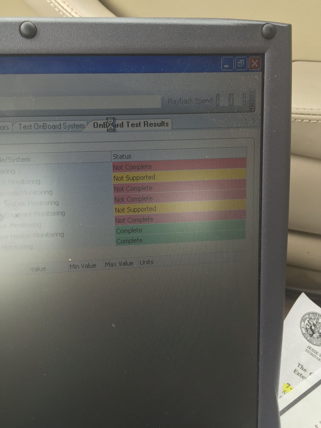

I'm trying to help a friend pass smog on his 1996 VDP/XJ6.
It sets 2 of them and doesn't want to budge on the other 4. I follow the drive cycle from the factory service manual and it still won't budge.
The car has an intermittent issue with the oil pressure sensor (gauge working on and off) could this be causing the problem?
There is no diagnostic trouble codes and check engine light never comes on.
Any ideas? It's driving me nutz.

The car also doesn't feel like it has 245HP.

So today I made sure the plugs have the right gaps, changed air filter etc.
Than I proceded to do seafoam treatment to the motor. To my surprise one exhaust manifold started smoking like crazy so I suspect it is cracked.
