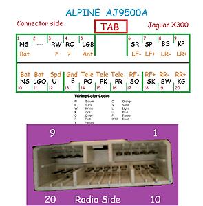

Hi,
I posted this question a while ago but no one responded so I'll try again as the issue I am having is so annoying.
The ignition hot lead that goes to my radio is NOT live while I am engaging my starter. I want an ign hot lead that is live when I crank the starter. Any idea if I can find one?
In case you are interested in why I want this I will explain. I have satellite radio that has a pause button. So it is very possible that I might be say 10 minutes behind live broadcast at any time. Let's say I bring my wife say to the grocery store for a few minutes and I stay in the car. I usually shut down the engine while I wait and continue to listen to my radio. The problem is when my wife returns and I start up the car my radio turns off while I am cranking the starter and when the radio starts up it is live and I lost the last 10 minutes. This is extremely annoying especially if you are listening to a talk show.
Anyone out there have any ideas to get around this problem?

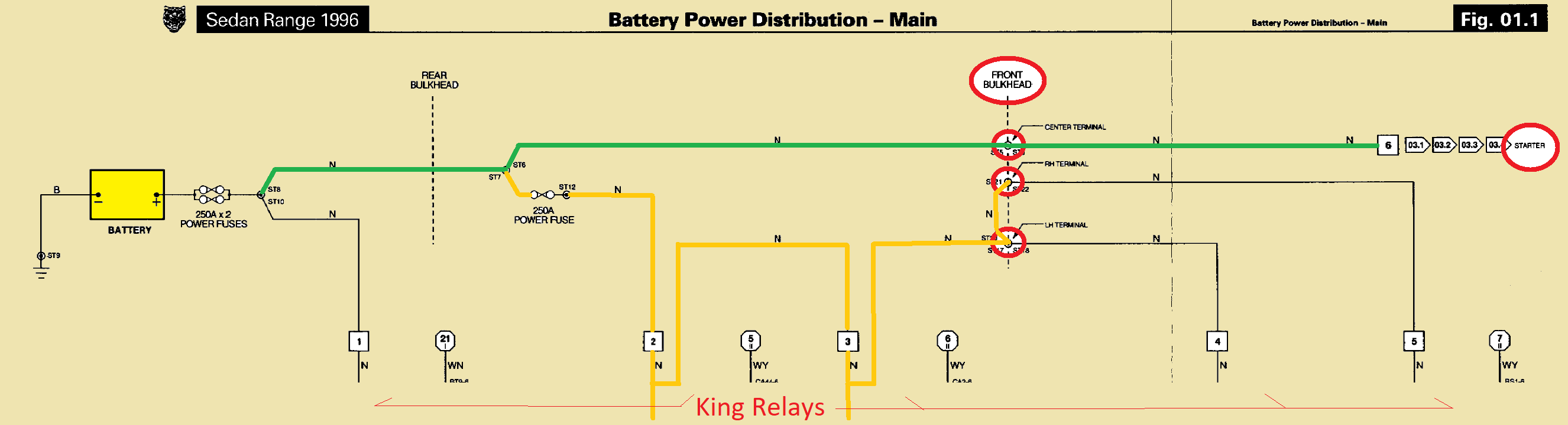

There are 3 B + inputs into the original Alpine AJ9500A stereo head alone . As to your substitution would probably need the pin out of the substitution unit's rear connector before the adapter harness . In this design parameter you wouldn't want it to come off the hot at all times bus but a switch to enable so for the few minute you are out and restarting . You have 3 hot at all times terminal post on the upper ( and I mean high up in there ) aft side of the engine firewall and can use a feed wire aft from there .

Had someone who had the terminal post to the starter came loose and wouldn't start so that would be a good choise to use and ensure that post is squared up .

See above edited print as you are tapping power before the king relays . Another option is to pull power from the hot at all times item's fuse location or the fuse box terminal post themselves . But would require running wire under center console . Choose your poison .
