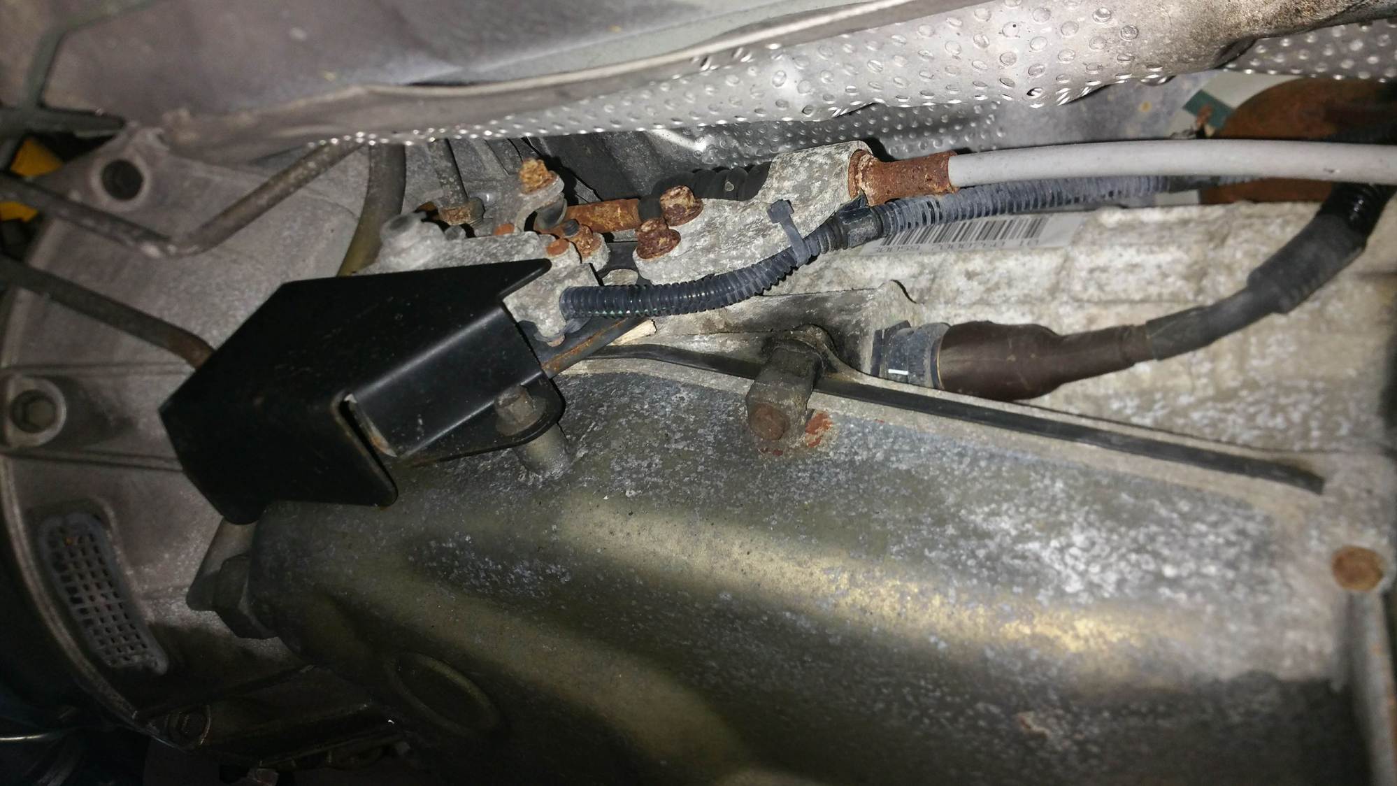

97 vdp, could this be a cover over the connector on the transmission body (for the wire that does the signaling to the transmission ECU)?
OK, I can't find the connector on the transmission body (that does the signaling to the transmission ECU), I know the connector is supposed to be on the left side aft (drivers side USA)? and no jacking required, but, I can't seem to find it. Coud it be the in '97 they put a metal protector around it I have to remove 1st? see picture. I did go to jag-lovers forum and find pics of the cable and connectors, but they were close-up and could not tell location.

The shape of the box looks right to be a cover for the connector
I can't remember if the wire bundle goes straight up to the shift gate area above the large floor pan sheet metal
The transmission ECU is located fwd of the front right seat on LHD US models
It's on the very bottom very fwd under the glove box and is made by TRW or Bosch with a long ribbon connector
Remember it is a push / pull connector and not a twist off. But I can be wrong as mine is stuck on some penetrate spray helps remove it

sorry for these giant pictures, but On further inspection, when I got the car up on ramps, I now think the black cover goes over the moving selector assembly, because I now found the connector visible, aft of that box. I can;t tell if I should pull the black rubber part, or the black plastic collar in front of it, ot twist that collar by the white line. Your picture shows those pins sticking out to the side, like they are where a twist-lock would secure to.

The 3 / 120 degree apart pins would indicate a twist off
The pins would indicate a quarter turn quick release and the white stripe painted barrel is what twist and not the rubber protective boot on the what's called the connector backshell
The later ZF 5 speed is a push pull
I never got mine off being stuck and too cautious knowing about the 5 speed and not wanting to break the connector
The device you see under the black cover is the rotary switch which is used in the starter circuit
