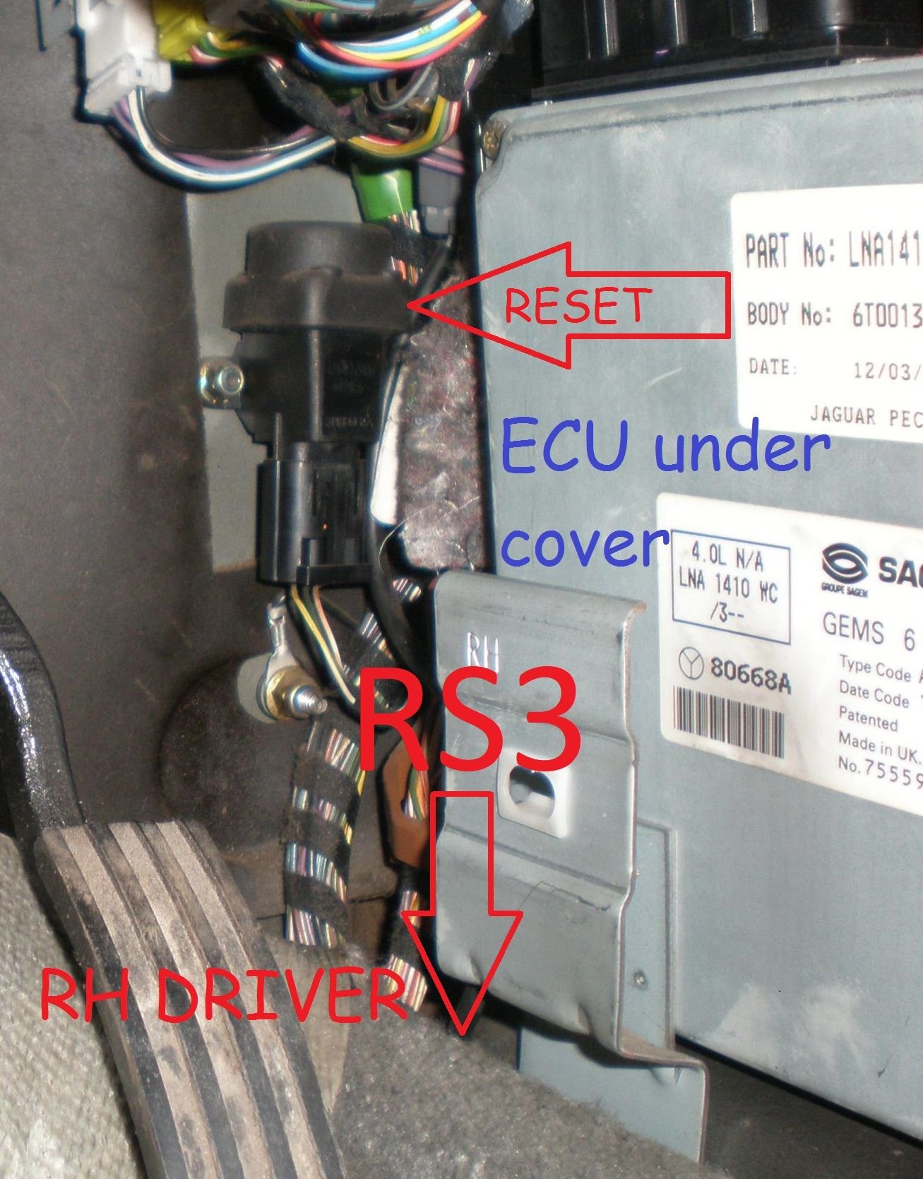

Inspect the engine ECU connectors on the ECU side for corrosion on the pins ( and inside ECU if allowed ) , ECU located always on the cars cabin side far right in front of the right front door hinge under a small panel
This pic for a British right hand steering model and remove the ECU to see down in connector , there is a external case ground wire that must be installed on the bottom mount bolt
The 3 videos can be slow to appear in this post but there after a couple of minutes
