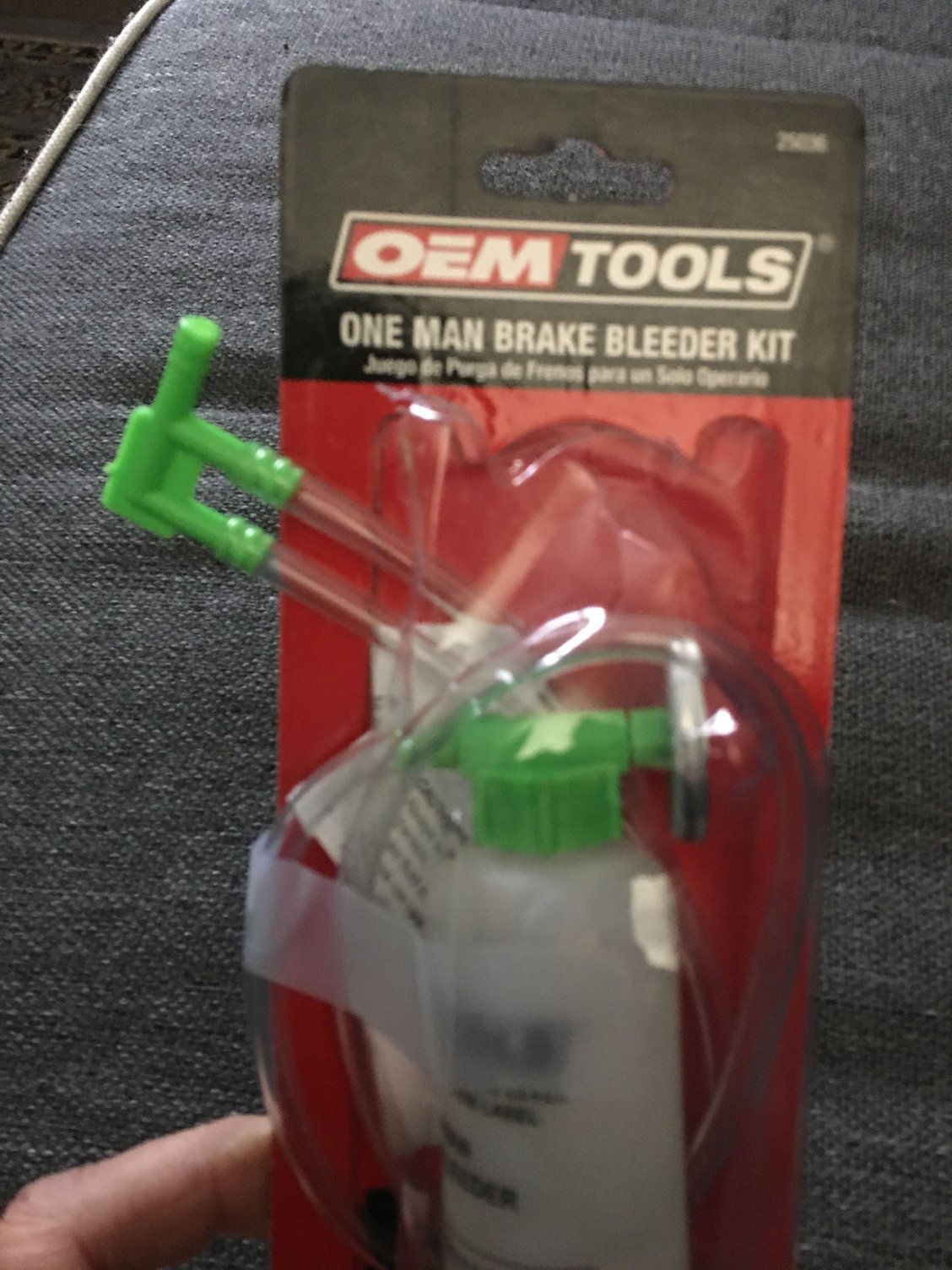

Just replaced a front frozen caliper. I needed 1/4” hex bit to remove the old one, and 7mm to install the new one. Rock auto had a rebuilt for $50, without a core return, so that was nice. Used a “one man brake bleed kit” for the first
Magnet holds the bottle
time, worked great!
