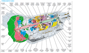

Since you have the Supercharged engine you have a different transmission then the other normally aspirated engine with the ZF4HP24 .
Yours is the GM transmission 4L80E

See link below concerning your GM 4L80E transmission :
https://www.jaguarforums.com/forum/x...begins-189715/
Attached Thumbnails checking transmision fluid properly-gm-4l80e-pic-untitled.png
