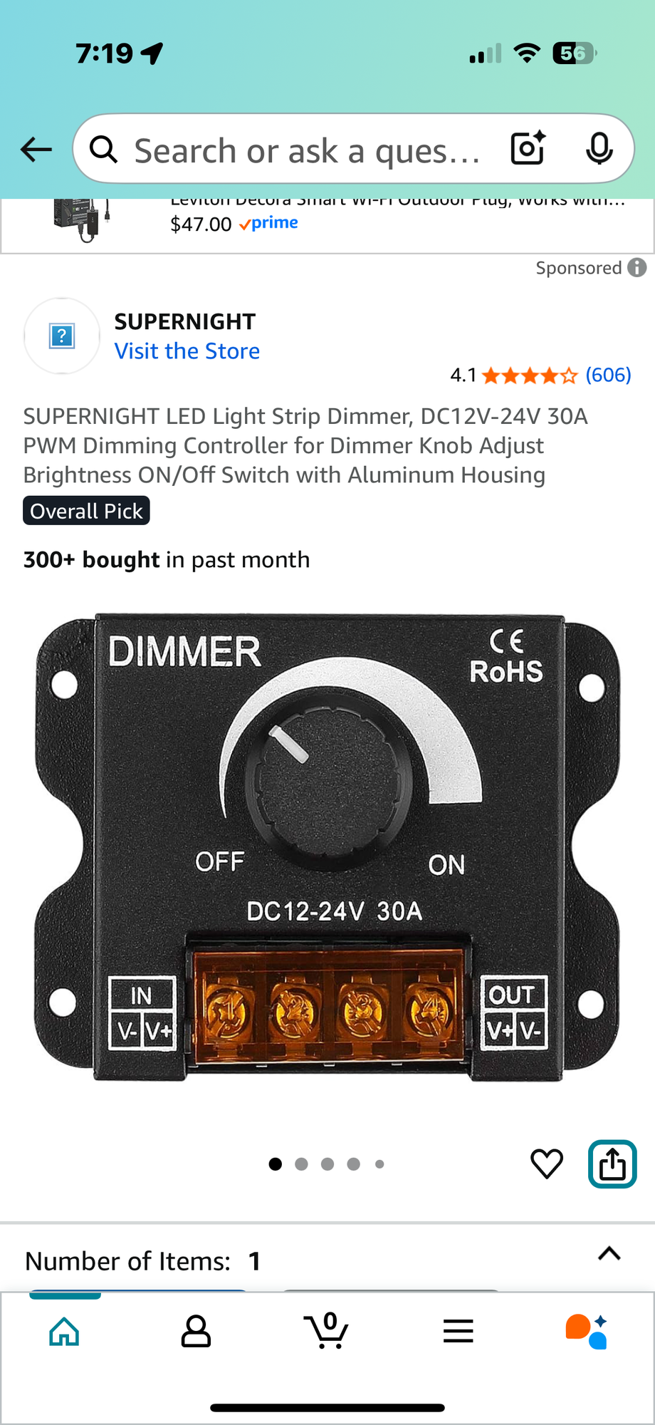

Old Sep 21, 2025 | 08:19 PM
cdma's Avatar
Joined: Dec 2013
Posts: 856
Likes: 276
From: Albuquerque, NM
I am going to give this a shot.
https://a.co/d/5l6yiBn.
