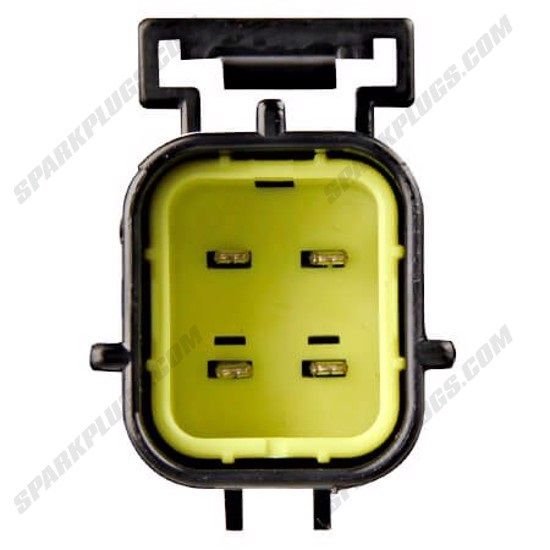

Remember you are looking for resistance between 2 pins for a Titania based sensor , the other 2 pins are the heater which is required ( you can test cold )
There is a map to installing sensors as the same connectors can be swapped
I have a 4 pin connector map I made several months ago and looking
Do not twist the pigtail wires on removal / installation as very brittle galvanized coated wire , mine had broken wires sticking out the insulation from previous owner

Pic on old broke computer , you can match it up with the car side connector as the colors are only valid on car side
