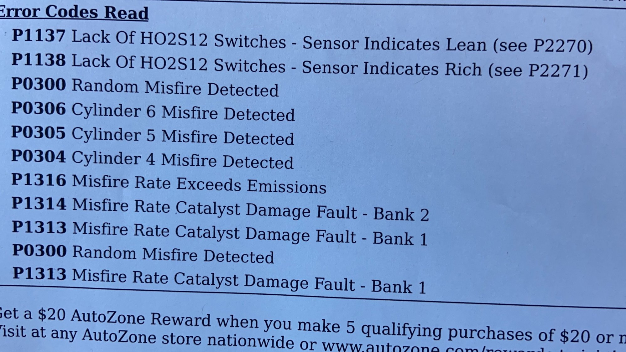

I have a 97 xj6 x300 with 85,000 miles and i need some help identifying these codes

Before replacing anything on the vehicle, be sure the battery is fully charged. Use a voltmeter to read the voltage across the battery terminals with the ignition in the OFF position. There should be a minimum of 12.6 volts present. If not, charge the battery for at five hours at 2 to 5 amps and retest the voltage. If the voltage is still less than 12.6 volts, replace the battery.
Have you removed the coil units to see if there is oil present in the spark plug wells? Oil can cause the coils to misfire resulting in some of the DTCs you list above.

I have and there was just a tad on the spark plug when i pulled it out and a little bit on the side of the actual well for the spark plug. And its only on the furthest 2 cylinders from the firewall

You can download the DTC Summaries manual from this forum at the link below. This will give you the model-specific Jaguar definitions and possible causes of each code:
Jaguar X300 DTC Summaries 1996-1997
Have you performed any service recently that could have disturbed the oxygen sensor connectors on the firewall? Disconnected or swapped O2S connectors could lead to codes like yours.

I have not done anything beside an oil change and brakes. I just recently got the vehicle so this is all new to me but i did check all spark plugs and coils, the coils didnt seem bad to be causing such a rough misfire and a little oil as mentioned abobe.The whole car shakes when id rove it around the speed would like lose pressure or something with no movement on the throttle. Also to note it is very hesitant to get up to speed i feel im using more throttle than necessary to get up to speed. Once up to speed it responds faster, no high idle it idles as it should but idk im at a loss rn

unplug maf when the car’s running and see what happens. almost aftermarket coils do fail suddenly and the misfire detection is very bad on these cars. unplugged rear O2s can cause crappy running.

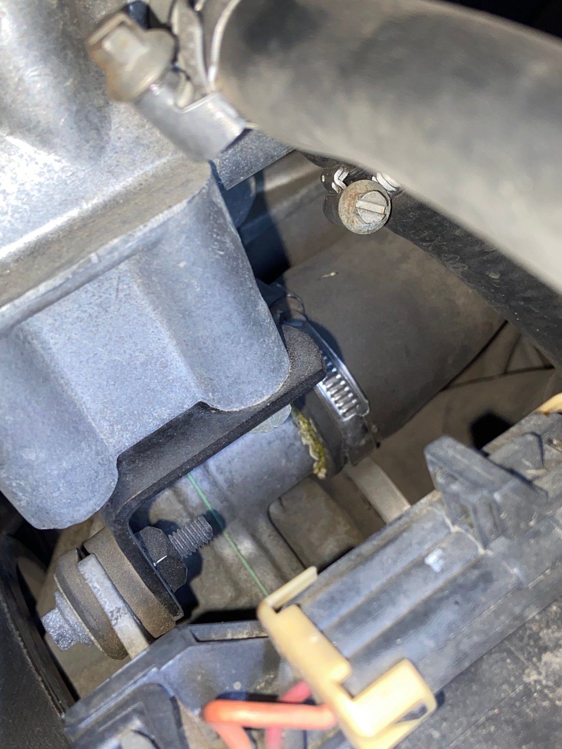

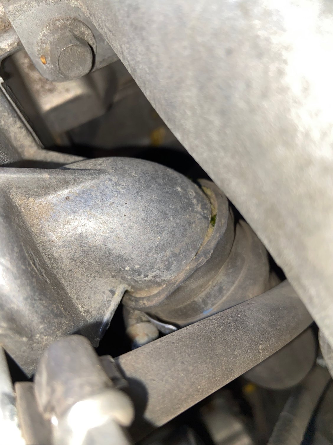

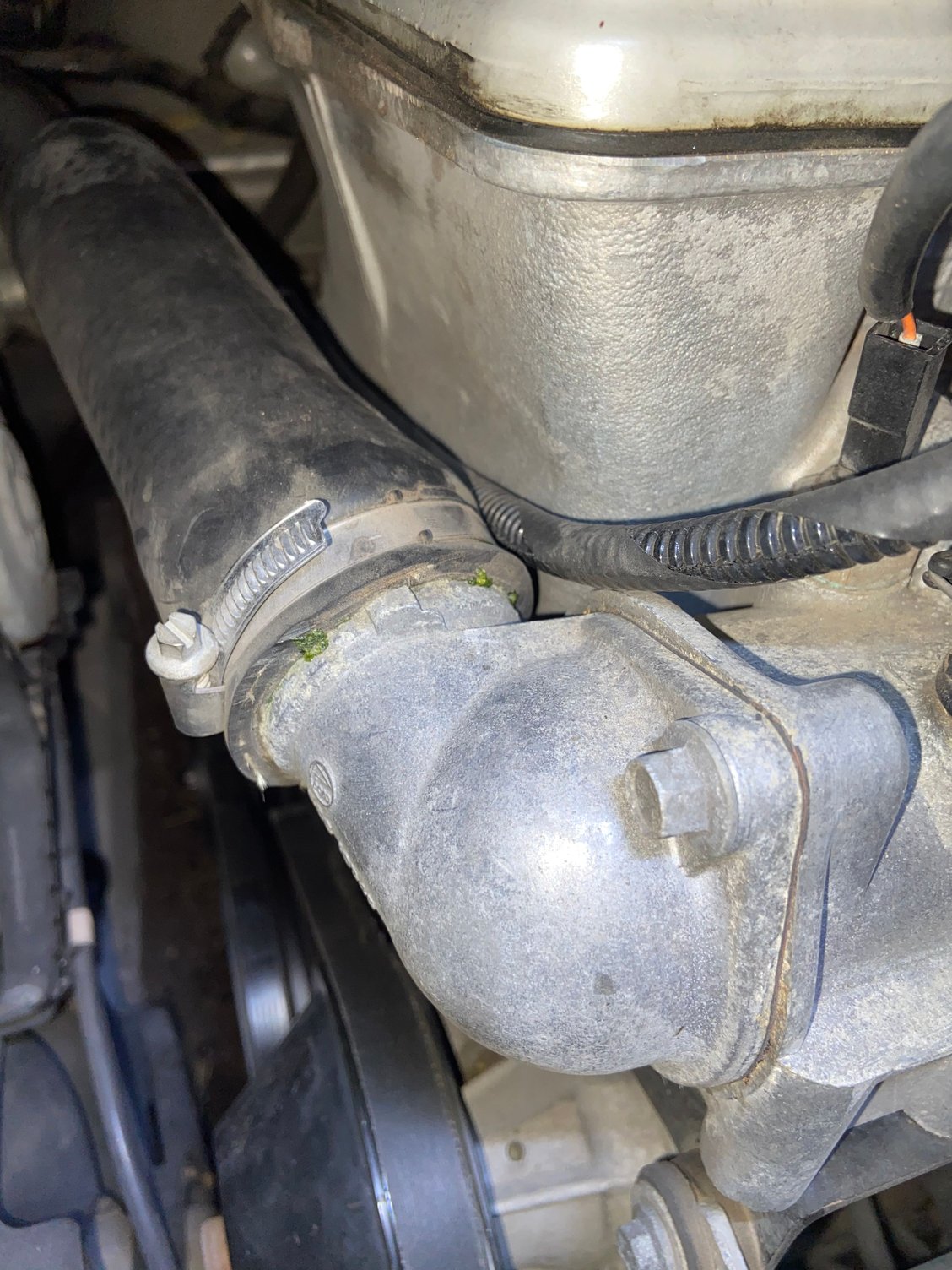

I live right next to an autozone that surprisingly is never busy(knock on wood) but i will need to get one soon but as of now this it what I've found. Also to note this very annoying rattling noise on cold start every time. I immediately turn it off and back on to try and mimic it but it only does it after sitting for a while. But for now i think i need some new hoses for these suckers right here

Ordinarily I would agree with Scaphan, but in your case it sounds as though your engine really is misfiring in multiple cylinders. Driving it in that condition can allow large quantities of unburned fuel into your catalytic converter, which will destroy the converter. Better to resolve the misfires first.
As xalty mentioned, the misfire detection on the X300 is poor, and we've seen many cases of misfires reported in certain cylinders only to later discover entirely different cylinders were misfiring.
One thing worth doing is to carefully examine the wiring to your ignition coils. The insulation becomes brittle with heat and age and cracks and falls off, leading to shorts. The worst spot is the bend in the harness at the rear of the cylinder head. Inspection usually requires carefully cutting away the wrap around the harness.
