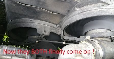

First, Thanks, The dash out guide and ebay info was excellent. I was bummed that I may have to do that (or worse pay for it to be done). I bought some a/c gauges, got a laser temperature gun, watched many you tube vids on diagnosing a/c issues with those tools. Today, I may have diagnosed the cause to be electric radiator fans, and may not have to take out the dash after all.in The pics attached you can see the high side pressure WAY up, yet both fans were off. High side gauge got up to 400 psi at one point. The temp at the high side port connector was 190-200 degrees Fahrenheit, Low side connector about 100deg. F (ambient temp 94 deg F.). I switched off the engine before the safety valve popped open again. THEN, the lower left side fan came on ! I restarted the car, the high side pressure dropped very fast to normal range. Then 2nd higher right side fan also came on for 1st time in 30 min of idling with a/c on. About time! Well then, that fan started squealing (bad bearing I'm sure). Fans will be replaced immediately, but, that's not solving the cause. My question is, how can I "hot wire" or force the fans on earlier, or find and fix the real cause of fans not showing up to work on time?
High side pressure kept climbing to 400 psi no fans would come on.
High side Valve got too hot to touch
Turn engine off, THEN lower left fan comes on ! High side pressure drops very fast to safe zone.
start car again and now both fans decide to come on. top right fan squeals off and on, bad bearing I'm sure.
My question is, how can I "hot wire" or force the fans on earlier, or, find and fix the real cause of fans not coming on when clearly needed?
