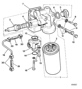

Today’s questions. I am changing the current by-pass oil cooling system over to the later full flow version. Stripping down the oil filter assembly and removing the oil pressure relief valve I released I do not know how to tell if it is good or not? By shaking it I can hear what appears to be a ball bearing bumping about and am not sure if this is good or bad.... it doesn’t look if it comes apart to clean or inspect? What are people’s thoughts? It doesn’t look like you can get new ones any more?
Secondly, in the oil filter body of the full flow system, there is a bypass valve. What is not clear to me is whether the bypass valve in the sandwich plate remains or is removed when changing from bypass to the full flow version. I am thinking it is removed? Jaguar sell new bypass valves.... do they fail ever and would it be worth fitting new?

Hi Grant, Yes that is the same route I took to come to the same conclusion. The jaguar parts catalogue lists that location as bypass only. I think it will be coming out!

As and when I get around to rebuilding my engine, I was wondering whether to change to the FF system. I have all the bits in stock. Anyway, I tested the oil temps, and the in and out temps from the cooler on my OEM bypass system. I used k probes and stick-on temp strips
I found that oil temps never went above 87C, even on the hottest conditions and in the hottest part of the engine. I also found that the bypass cooler took 20C out of the oil temp across the cooler, so I wonder whether I shall bother or not.
The FF system does have a pressure relief valve (basically all oil pumps must have) in exactly the same place, with the same question-mark pipe on the end of it, as the bypass system. I say this because my spare FF filter head has all these bits on it. In addition, the FF system has a relief valve inside the oil filter chambers in the head unit, so that if the cooler gets blocked the oil can go direct to the engine oil distribution system.
I did take the relief valve apart once, from memory if just unscrews and it basically just a big spring holding a valve shut. When it opens the oil goes direct to the sump via the casting held by the triangular three-nut-fixing casting, not via the question mark pipe - which is there for I am not sure what, maybe to syphon off oil that creeps past the valve piston? Mine does not rattle, so a rebuild a good plan!
