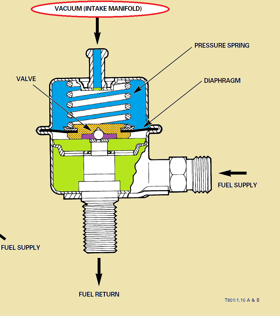

The regulated pressure trapped by the FPR should be 43 PSI at idle and goes up to 46 by the vacuum line on top of the FPR generated by throttle up the RPM's
You can see the 43 PSI without running the engine
You can jumper the fuel pump relay to command it to run at all times between socket 30 and 87 . this is the aft most socket position to the forward most sockets position
The 2 sockets on the sides you will leave alone

So could the FPR be bad if proper pressure isnt there ?
Old Aug 17, 2020 | 07:29 PM
Parker 2's Avatar
Joined: Nov 2019
Posts: 545
Likes: 261
From: Kansas City
Yes , they don't last forever and they are a common easy to find part , not jaguar specific
