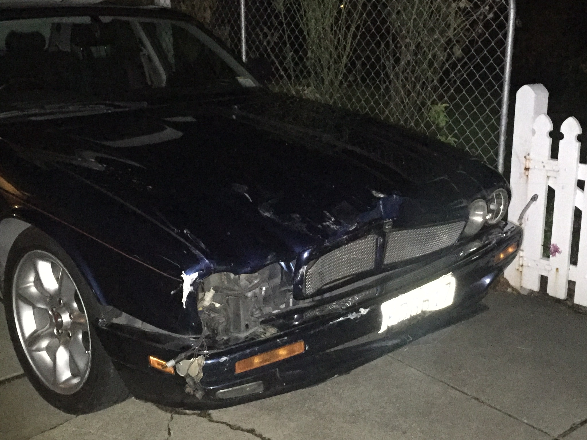

In a moment's inattention driving home from work, I rear-ended a Toyota Starlet which hit a 325 in front, which nudged the next vehicle. They had all come to a sudden stop for a pedestrian crossing, and I wasn't looking. It took about 2 seconds. I was going about 40 km/h in a stream of slow, tailgating traffic. My fault.
The Starlet went to the wreckers' on a tow truck . I drove the Jag 2 miles home, with one headlight.
Luckily no-one was hurt.
I thought they would write the jag off, but I have a good insurer and I have explained the nature of my car to the assessor who 'get's it', so it will be repaired.

Looks like quite a hit even though it was a slow impact at 40 km/h: front bumper and chrome pieces, bonnet, front grill, right headlight set, and possibly air-con drier and condenser (hopefully the radiator ).... But is is good that no one got hurt. No doubt, she will be repaired in no time, treasured more, and you will be more alert when driving.

sorry to hear if your accident, but pleased that nobody was hurt and the car is to be repaired. Difficult to tell from the photos, but did your airbag deploy?

No airbag deployment, which is a bit of a worry. I had probably just touched the brakes without really losing any speed, so I don't know it that influences the airbags. I would have expected them to go off.
Begs the question whether they work or are even there any more..

The air bag sensor unit is usually positioned behind the front bumper. It looks like most of your damage was above the bumper line. The bumper may not have been moved enough to set it off. Actually, unless you were injured it was best that it didn't deploy. That would have added the cost of a steering wheel, dash panel and two air bag units, probably another grand at least.

I was completely fine so as you say, good the airbag stayed in the wheel.
I think the Starlet I hit absorbed most of the impact, and I was probably just a starting to brake.

As far as I know, the sensor itself doesnt need to be struck, as it can sense the impact through the "jolt", regardless of whether it is physically hit. There seems to be a degree of science involved in the sensor determining whether to fire, and it isnt just a case of being related to speed at the time of impact. Rate of retardation seems to come into it, eg Hit a wall at 30 and it will fire, hit a hedge at 60 and it wont. It could well be that yours is functioning correctly, and toyota starlets are so mushy it didnt need to go off!
The systems are pretty tamper proof, and if the electronics dont like anything, the warning light will come on, and be virtually impossible to extinguish without fixing the fault; even removing the bulb causes an audible warning!
I take it when you were driving the car after the bump the airbag warning light wasnt on? If it had triggered a deployment, the light would be on, even if the bag had not actually fired due to a fault.
