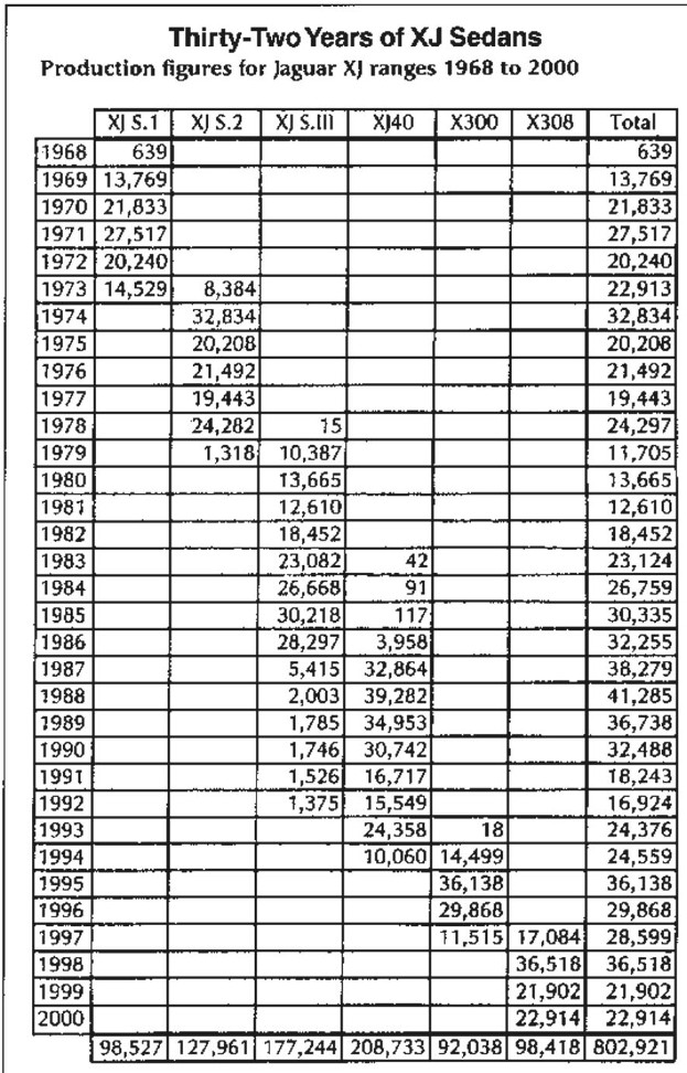

you might post your question in the X300 forum, your car is not a XJ-6 but a X300.
see below chart
