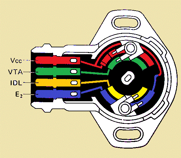

The X300 TPS is 3 wire and can be read with a meter with the engine off at the ECU connector as you move the TPS through it's range .
Wire GY is Red 12
GB is Black 7
UW is Red 11
X300 N/A and S/C is the same.
Look for a bip or spike to high on a needle meter as resistance as you sweep it through , my not be able to see with a digital meter .
####### RESULTS #######
Paper clip into Red 11 to Red 12
Idle =640 ohms
Full Throttle = 2325 ohms

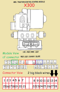

Attached Thumbnails Dash Warning Signals-x300-tps.png   Dash Warning Signals-x300-ecu-untitled.png

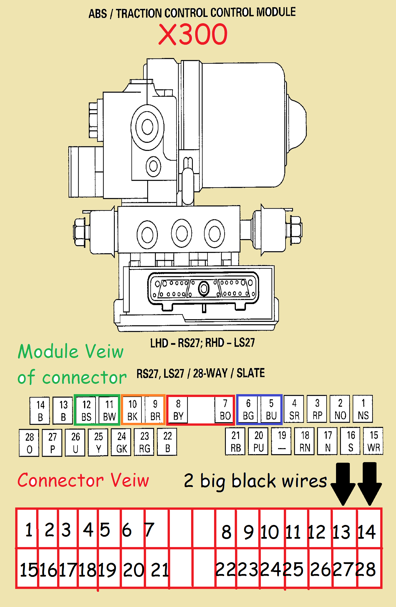

After rechecking at TPS sensor at setting 0.601 volts at idle stop
Idle Throttle = 2235 ohms
Full Throttle = 230 ohms

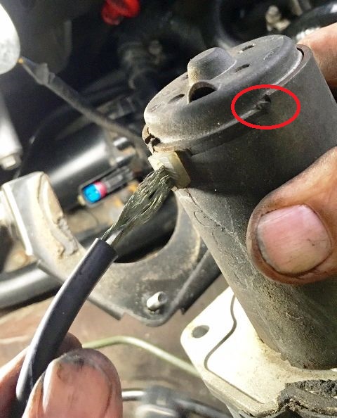

Air Bag - bought a full set of used Air Bag Impact Sensors and Control Unit. Replacing just the front impact sensor on the driver side already sorted the airbag light on the dash.
ABS and Traction Control - bought a good used ABS Pump with Traction Control (very difficult to find). In trying to remove the old one, the mechanic incidentally found that the connecting wires at the bottom of the Traction Control Actuator fully exposed - the cable sheath was long gone (as per Lady Penelope's suspicion in Item 4 of post #35 above) so both wires are entangled together (see picture). The mechanic traced the disappearance of the wiring insulation to the other end of the cable - evidence of what time and heat have done to degradable rubber.
This explains the dash warning as well as the earlier find that the actuator motor being faulty. Parts Number is MNA5930AA but is no longer available, new or used. Found another part number on the old unit, which reads 93BB 9U558 AF, and then found several used unit on eBay, some labelled as Ford throttle cruise control unit. Ordered one and see if it would sort the ABS and TC warning light.

I plan on drilling out the spot in the red circle to remove and replace the wires . With some penetrating oil and some heat it might spin off . Then at a muffler shop I will have them spot weld it back .
Attached Thumbnails Dash Warning Signals-x300-fullsizerender_9f675dce5ba71ec6dd0fdbf8a0c100ceabaf0e2c.jpg

Yeh, my mechanic planned on doing that too, but advised that it would be much safer having a spare available just in case the drilling fails or the inside is beyond repair. The one I bought cost only GBP 8, with original wiring looking good.
