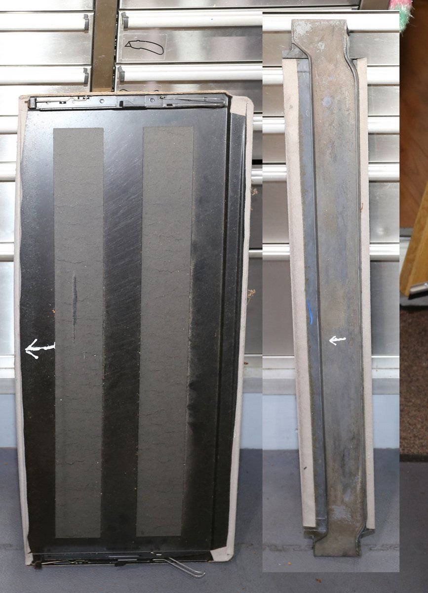

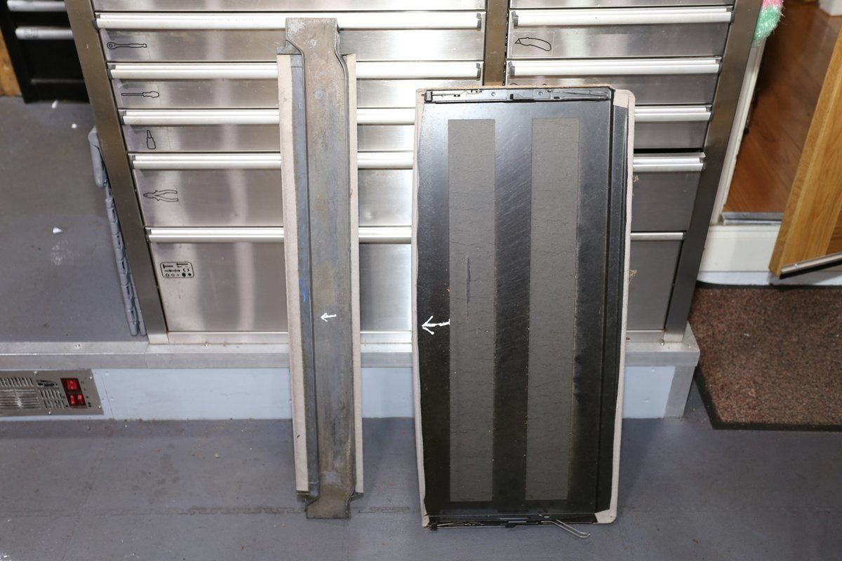

Here's some pictures of the sunroof panels that may help. The arrows on the upper side point to the front of the car. It will give an idea of what you're dealing with.

Oh, that's right...you do need to recover the drain-channel while the headliner is out! forgot about that.
Brendan, I'm only seeing arrows in the middle view...and they seem to be pointing to the rear rather than the front? The drain channel definitely rides aft of the major panel. Or what have I got mixed up?

@aholbro1
Yes you're right that the small panel is at the back. The arrows are correct on each panel but the positioning of the panels relative to each other in the picture is confusing. Photoshop to the rescue and here's a less confusing edit.
