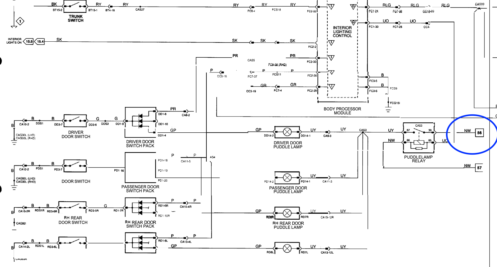

Which fuse feeds the door guard (puddle) lamps? It's not listed anywhere in the owners manual. Thanks for any pointers

For 1995 at least, looks like RH Heelboard #8

Is the real issue here another flickerer? If so just pull the lamp. F8 feeds all of the interior lighting and the trunk lights.

No, not a flicker problem, just all 4 lamps are dead. I had some work done on the door and ham-handed Harry apparently shorted a lamp connection. And now I notice that all the cabin interior lights are out too, so the F8 fuse is going to be the answer. Thanks to all for the guidance.
