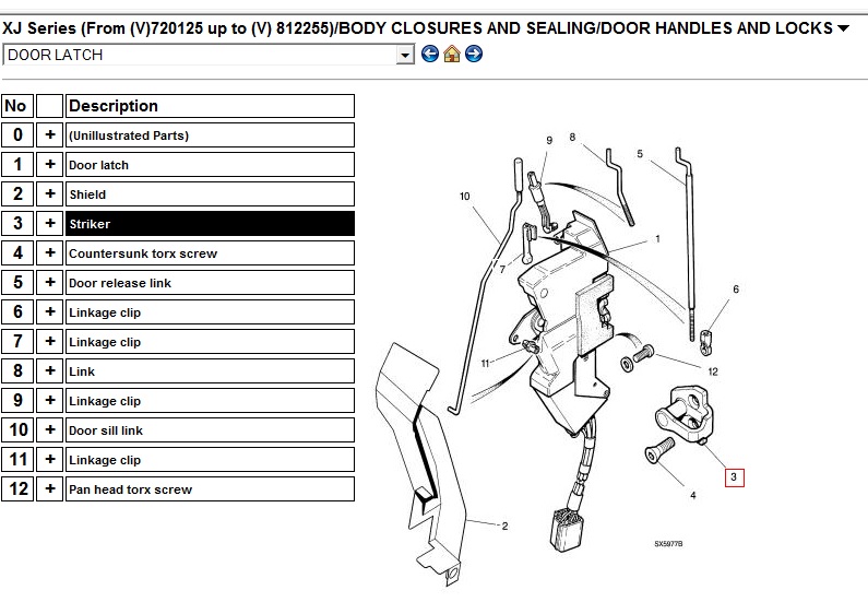

This is not normal. The doors should open and close easily. Assuming no distortion from accident damage, there's three possibilities:
1. worn hinges - allowing the door to drop
2. door Strikers - out of adjustment
3. door Latch - not releasing
Check for (1) by trying to lift the open door from the lock end. There should be little or no movement. If there is, look to see if there's is play on either upper or lower hinge pin.
To check (2) - with the door ajar, hold the outside lock handle in the open position and slowly close the door. I shouldn't foul the striker (item 3) on the door pillar. in other words, you shouldn't have to pull upwards on the door to get it to engage with the striker.
Latch problems (3) need the door card removed to be able to see the levers are operating properly. If they are moving correctly with the handles, it points to issues with the latch electrics preventing automatic release.
