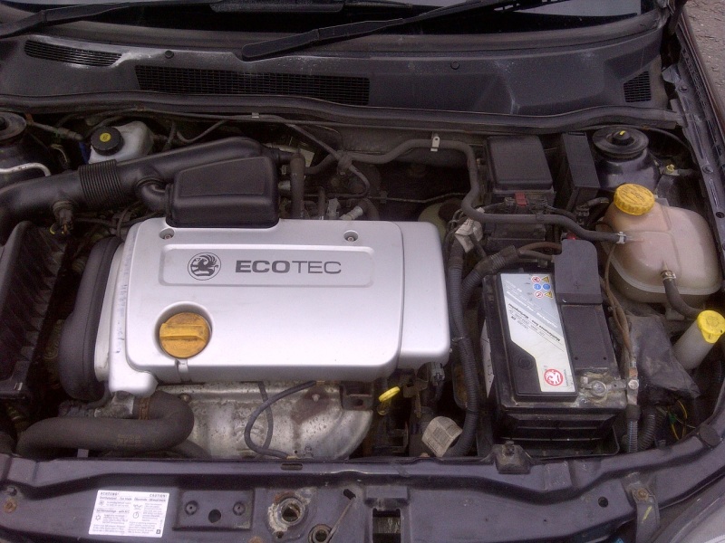

Here's a few before and afters on my sons old run abouts. Please bear in mid these are only small old daily drivers, using the processes above took around 30 mins.
Vauxhall Astra Before
Vauxhall Astra After
Renault Clio Before
Renault Clio After
Its only a very basic outline, but no engines were harmed whilst following this procedure
Hope it helps
