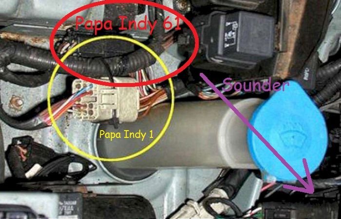

There are some ground studs you can clean along with 1 connector as this one
PI 61 position 12 White / Green wire , it will be the one in the black connector corner as the one in the pic is hidden

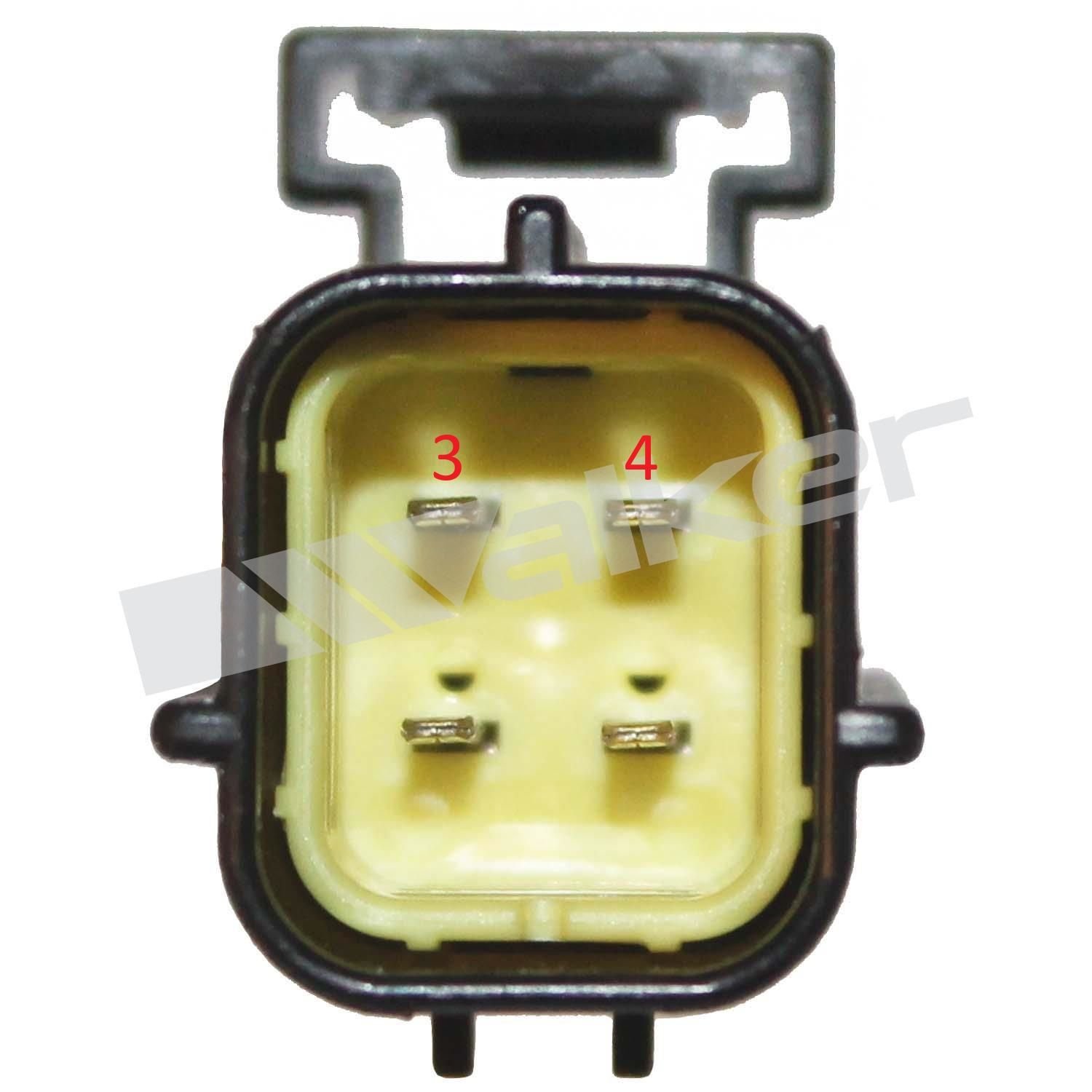

And the sensor pigtail connectors
