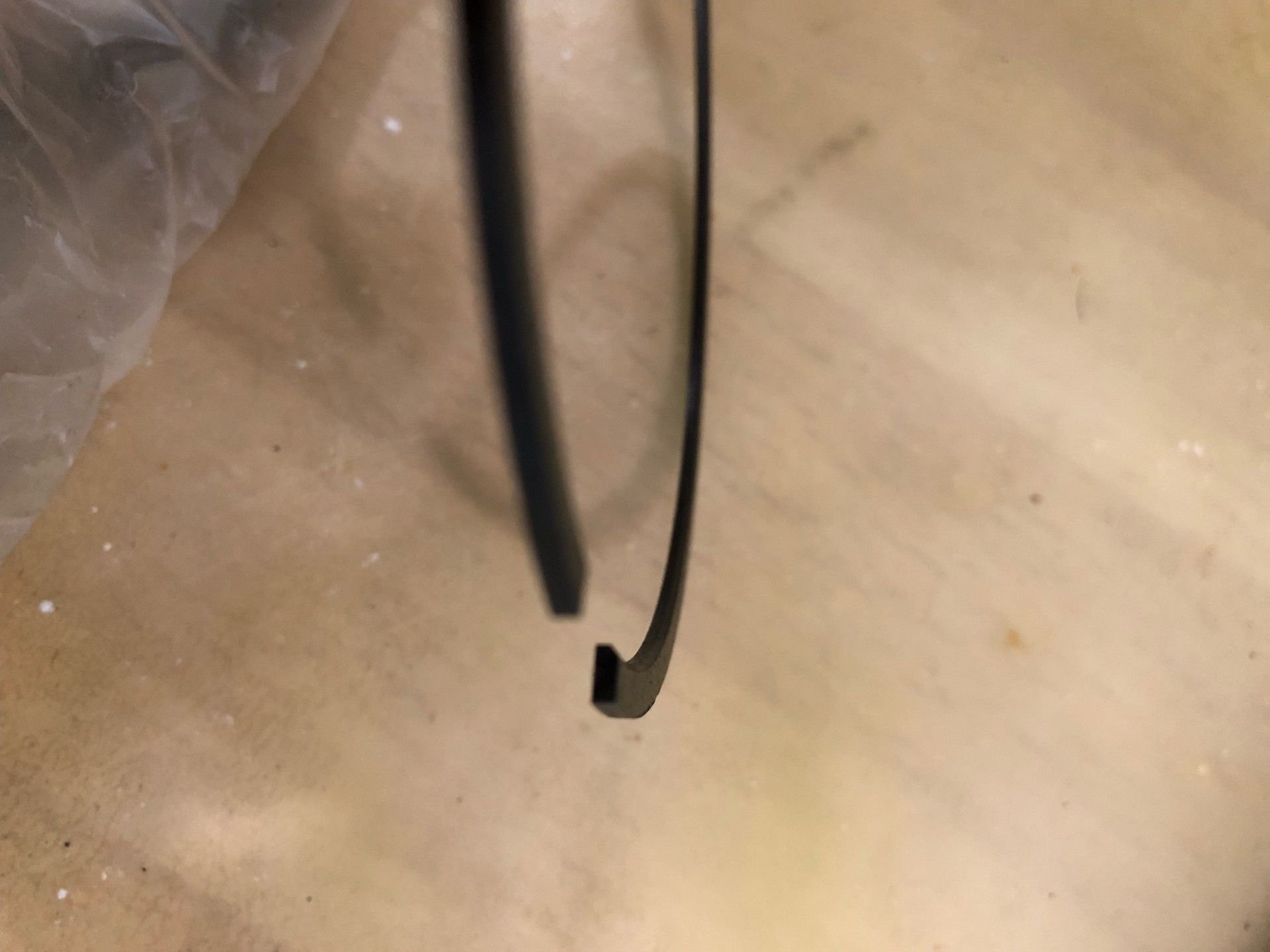

Okay, so I have solved the piston rings issue to my satisfaction. I contacted the old supplier of the piston rings for Moss Motors after I was informed that they had gone bankrupt. After some research I found out that they haven't quiet gone bankrupt, just reduced operations
The supplier is Deves (Shop High Performance Piston Rings Online - Deves.com). They are only open on Monday and only respond on the phone. So you'll need a little patience. The rings they sell are cast iron. Have no coatings. So I ordered a set (you have to order by dimensions). The first ring and the oil ring look different than the ones that came on the Jag from the factory but will work. The second ring has the same profile as the one from the factory
If you recall the rings from Grant piston rings are a match for the first and the oil ring
So you could simply mix and match (both let you order individual rings so you can save money that way)
The only difference is the coatings. Jaguar used a chrome coating. Grant can provide either chrome or cast iron with a phosphate coating. After speaking to engine builders, the coatings will not matter. Chrome-coated rings would take longer to bed in than the cast iron ones
Please see the attached for further edification
Grant piston rings' first compression ring. Note the profile
Deves' first compression ring. Note the profile
Deves' second compression ring. Note the profile
Deves' 4 piece oil control ring
