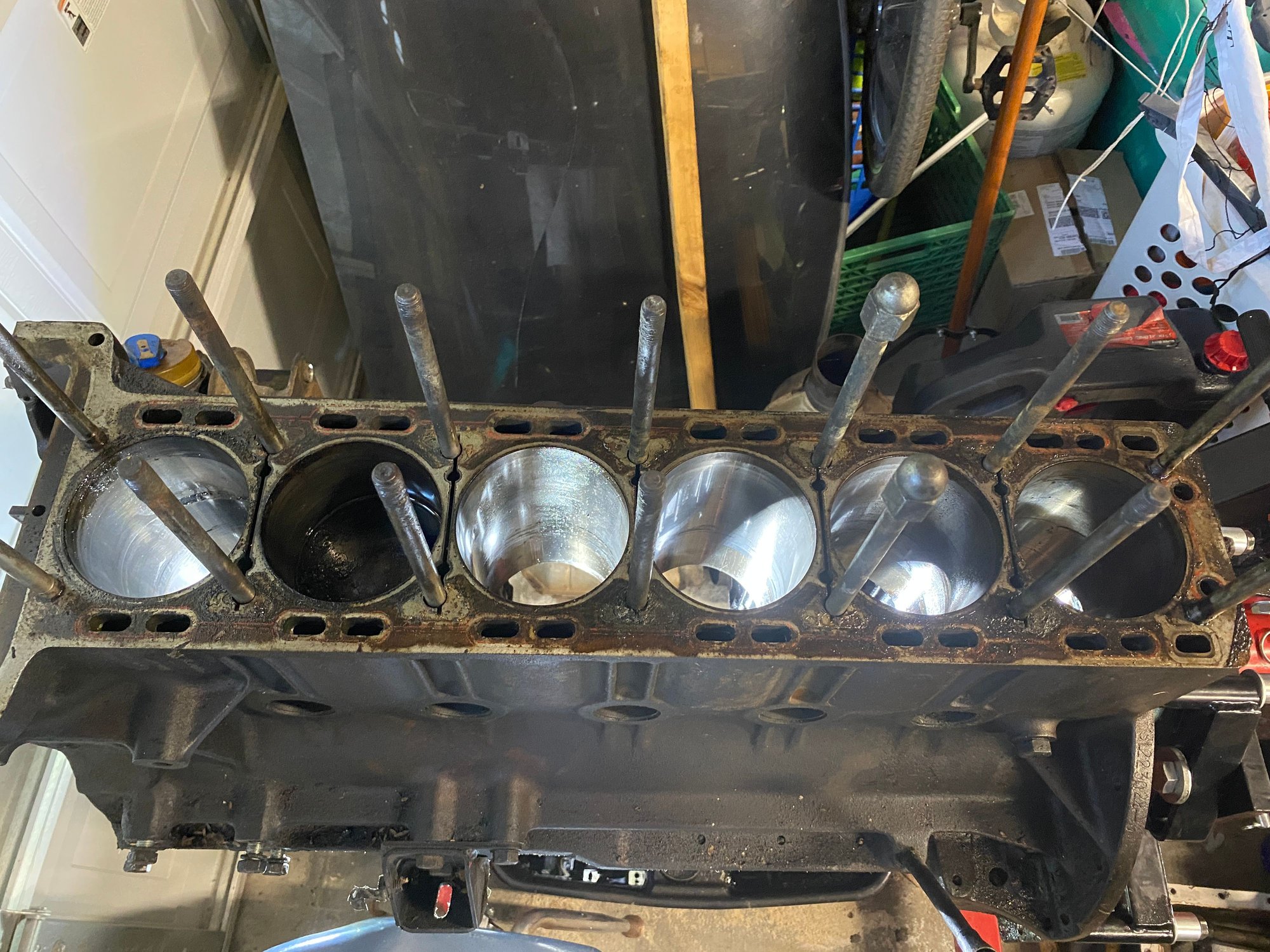

When you say "a slotted block", I assume you are referring to the slots between cylinders? If so then yes. Here's a pic - the block is actually in very good shape, with very little corrosion and the cooling system was very clean (oily grime notwithstanding):
Is skimming the deck really necessary if it cleans up nicely?

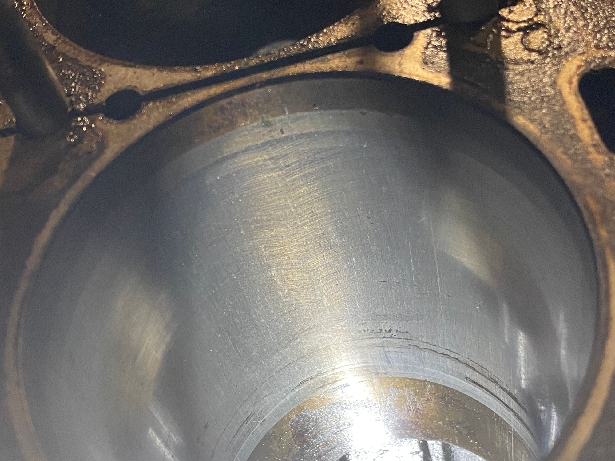

Here's what cylinder bores look like:
Given all this I'm thinking of not worrying too much about deck skimming, opening up all the plugs, etc. First a careful but not too thorough cleaning, then I would have the crank polished (TBD if necessary), replace all bearings and seals, lightly hone cylinders, new piston rings, new timing chains, and a valve job (head looks pretty good, so TBD if necessary). Am I grossly underestimating the size of this job? Tell me if I'm nuts. I have to be honest here - I have done a lot of repairs but this would be my first engine rebuild. Trying to create a reliable driver but not spend a fortune.

going well, check if the ridge in the bores needs a skim, stuck piston, thin machine oil or dilute engine oil down around the piston edge, leave for a while then try move up a little then down then up and so on till it feels free to move out......do you have a 3 arm deglazer or brush type for the bores?...can you post a pic of the studs into the lower block?

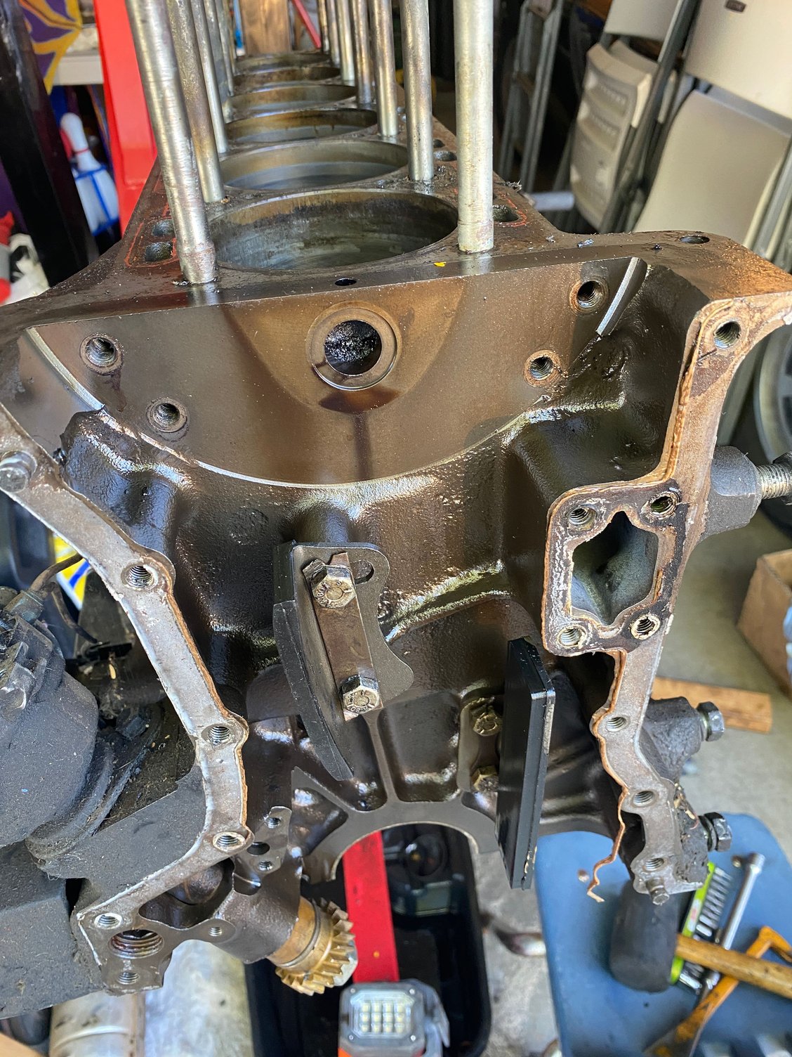

I don't have anything for the bores yet - will need to buy something. Pics:
(middle cylinder in this pic was the stuck one)
View of block from timing cover area

looking good, a 3 leg deglazer or bore brush will do, either of those should clean up those ridges, looks like you'll be able to do the bare minimum to get it running again.....i'm sure you'll get lots of expensive advise on how many thousands you should be spending but i'm a cheap-o, don't cut corners - just do it on the cheap...

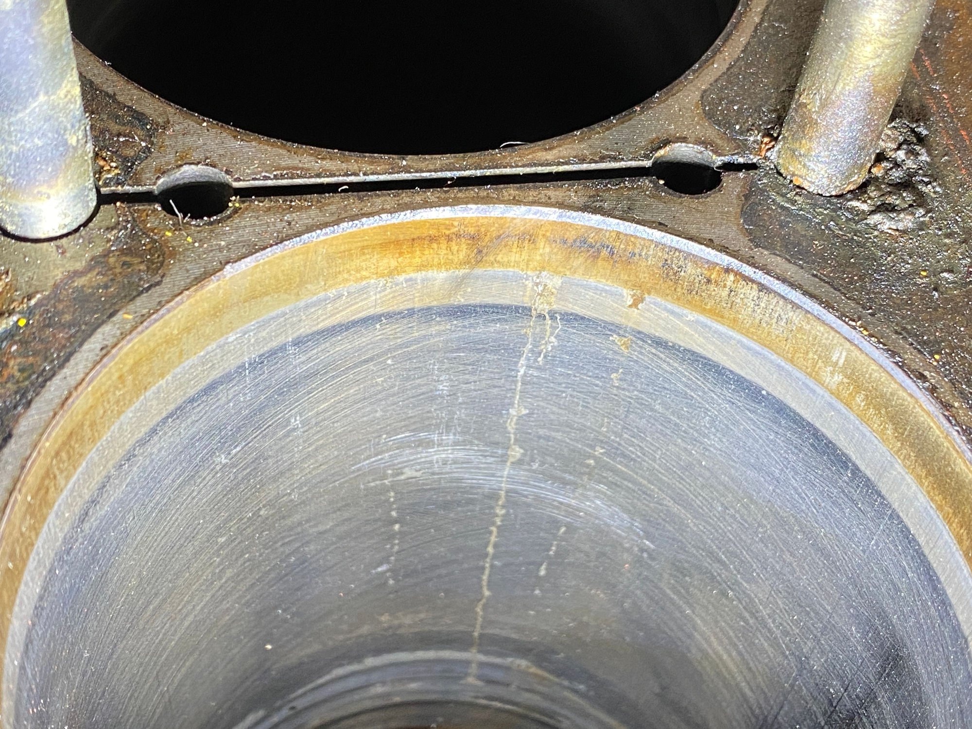

I may have been overly optimistic when I looked over this engine block initially. Taking a closer look one of the cylinders has me worried. Thoughts?
Is that a crack going allll the way down the cylinder? Is this block now scrap?
At first I was thinking it was just surface residue but I tried to scrape it away (probably shouldn’t have) and the more I look at it the more it looks like a crack. Might have to take it to a machine shop for evaluation.

A crack to me seem to be unlikely given the construction of the block (no wet liners) but I doubt that you will get away with a light honing as the ridges in all cylinders seem to be quite deep. But difficult to judge from the pictures only.
If the deck of the block cleans fine I think you may get away with it without skimming. but I advise to have the head checked and if necessary skimmed as they do have a tendency to distort.

Being a 4,2 Liter it shall have dry liners if I'm rigth.

Get a dye penetrant kit !

The slotted block engines don't have liners. Liners were used on the 7L and 8L blocks to cover machined coolant passages in the block. To be frank, the 4.2 was probably the worst of all the XK engines, although the earlier 4.2s, with their short head studs were mostly OK.
If you look at the videos on ths YouTube site, you'll see these coolant passages exposed. The block was being restored to use after suffering cracking between bores, by the use of lipped liners
