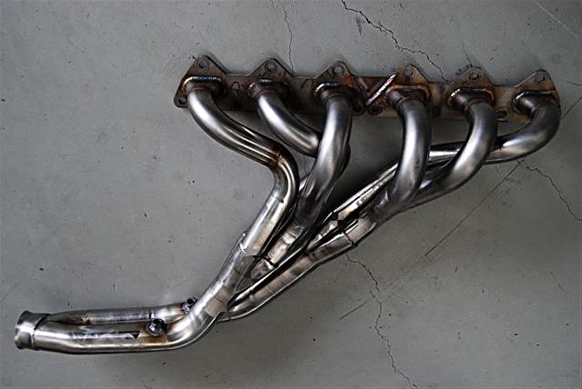

I make performance replacement headers for these cars from 304 stainless steel direct fit but not cheap
When you have repaired them a few times the price seems reasonable (LOL)
